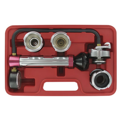

Yours must have a pretty good sized crack in it. I was thinking you'd need to have it running for it to build some pressure and leak.
I guess another way would have been to put a cooling system pressure tester on it to see if it leaked into the cooler but it's always nice when it's easy like in this case.
