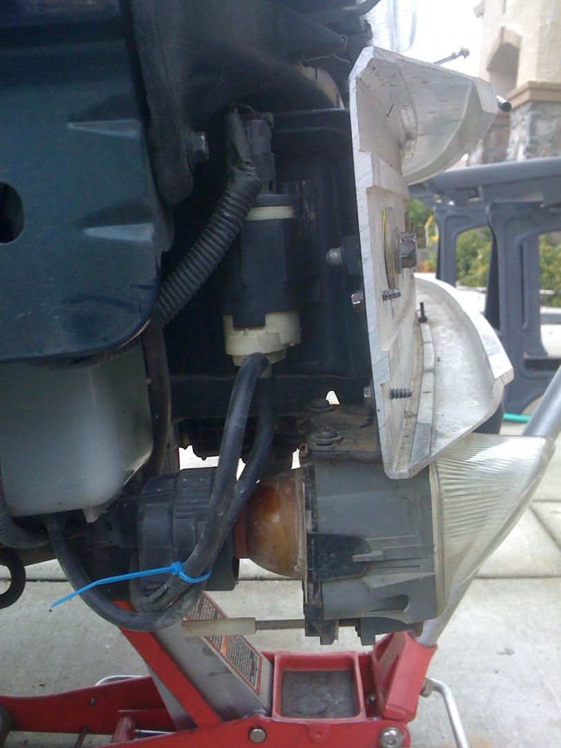

Here is a factory fog mount:
https://volvoforums.com/forum/attach...e-wing-016-jpg
