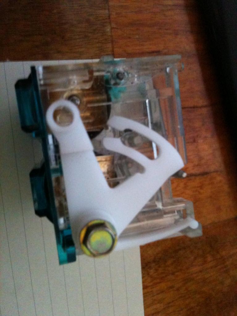

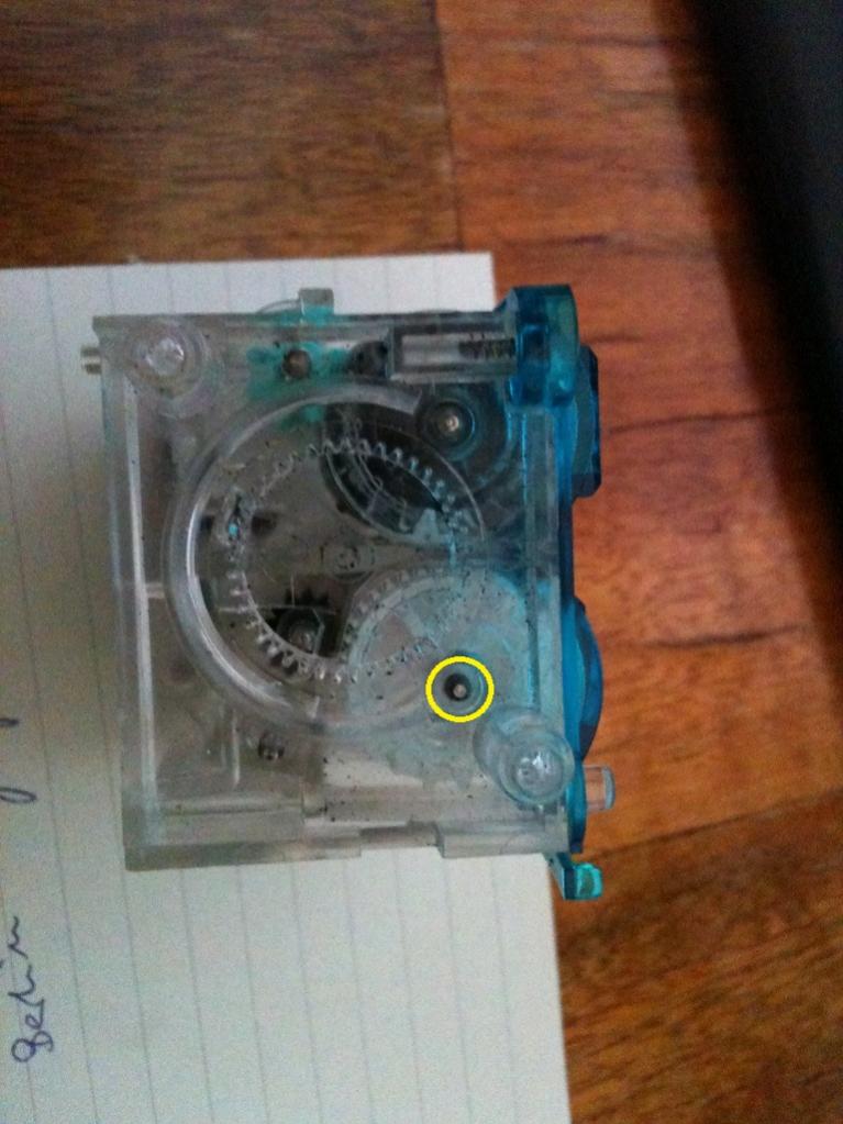

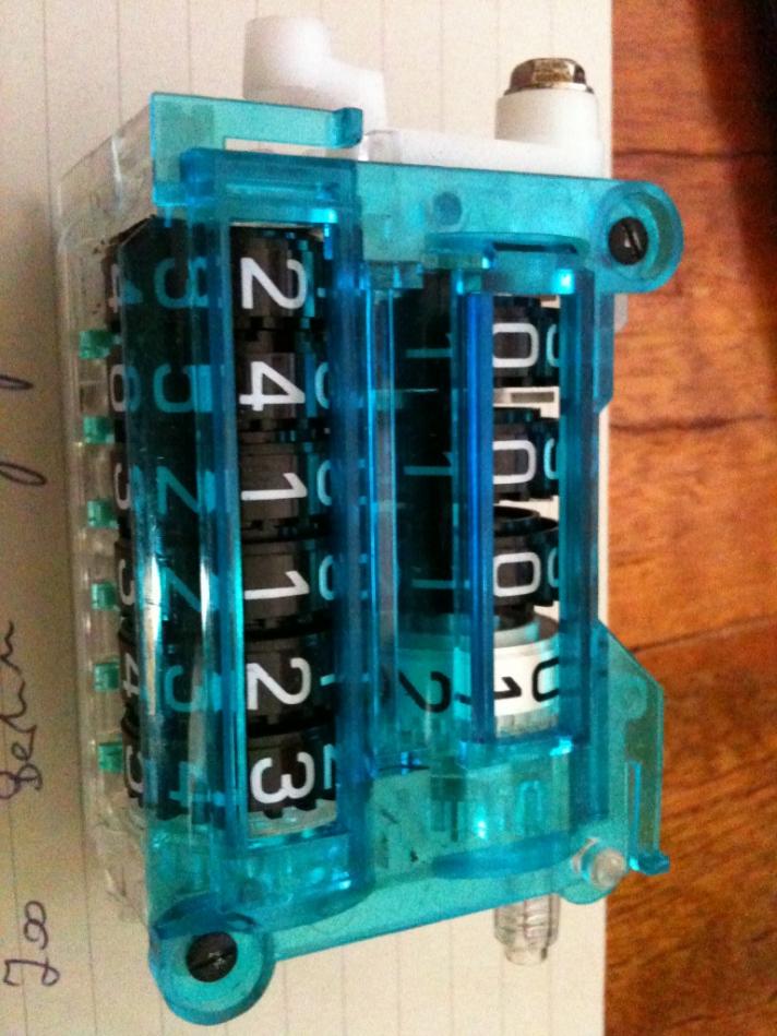

You can press out the metal on which the numbers are located and than make any combination your heart desires.
Watch out only to match the barrels when reassembling. They have a "dent" . Take a look at them prior to taking them apart and you will notice what I mean. Otherwise they will not turn correctly and you will have half of a number and half of the next one in the opening.
The first time I tried by the "drilling" method I only broke the big gear.

I marked in the pic the part you need to push back (no need to push it completely out if you are only changing the first numbers)
