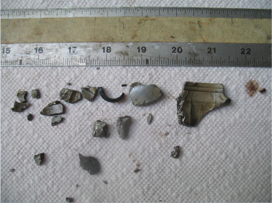

Yesterday I pulled the oil pan, thinking the noise was caused by leaky O-ring seals. It turns out that one of my pistons has partially shredded! My buddy and I started to rip the head off and removed the piston; took a few hours to get at it. Unfortunately, we had to undo everything we did for the Valve stem seals & lifters to get at it. What's worse is that we snapped a head bolt in the process I haven't even begun to worry about that yet.
Attached Thumbnails hydraulic lifter noise-volvo-850-removing-piston-004-small.jpg   hydraulic lifter noise-volvo-850-removing-piston-041-small.jpg

Looking into the pistons now. Volvo has a piston kit for $120 but we're not sure if it contains all 5 or if VADIS indicates we need to order 5 kits to do the job.
If you have the time, remove the cam cover and check each lifter by pushing down on them with your thumb before ordering replacements. They should be rock solid. if any of them bounce, it's toast. I had 6 out of 20 lifters that were shot. IIRC, they cost 16 bucks a piece, or $170 for a full set of 20 from FCP, so it was a no-brainer to replace all of them. Plus, I've read that it may be necessary to reinsert each lifter where it came from, and that seems like a mess waiting to happen so it was another good reason in my mind to replace them all.
Looks like the price is for one piston and does not include the rings, which is another 50-ish bucks.
