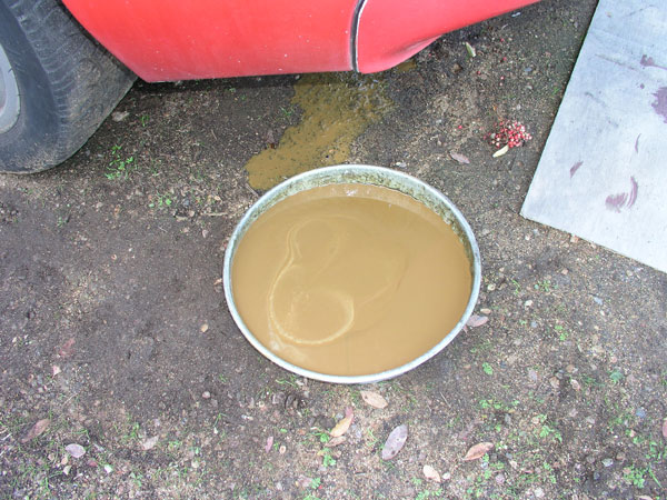

Dear rickheel. Now you have your own thread. Please don't tack you problems onto someone else's thread, it's called hijacking. Did you read the other thread to see what solutions you might find ??
If you needed to add two bottles stop driving the vehicle immediately before you lose the engine.
If you added two bottles and can't see it running out someplace you have to have a leak to the inside of the engine. It would need to be a bad head gasket (very likely) or possibly a cracked head or cracked block (not likely).
Once you fill it up with coolant and let it idle do you see white smoke coming out the exhaust, an abnormal amount of it ??
Is there and sign of coolant in the oil ?? Does it look like milk chocolate ??
Attached Thumbnails Keeps losing coolant, can't see a leak ??-headgasket-drained-milk-way-oil.jpg   Keeps losing coolant, can't see a leak ??-headgasket-engine-draining-milky-way-bar.jpg
