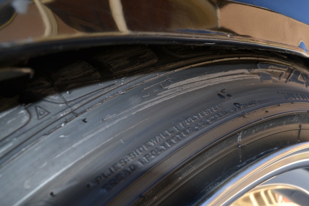

Have they been sitting outside for a while? Are they trashed?
Old Mar 29, 2012 | 10:30 AM
  #42
The car has been down for about 8 months now. They didn't look to bad, mostly road wear. You can let stuff sit out around here forever and it not be bad. Warm weather and lots of humidity.

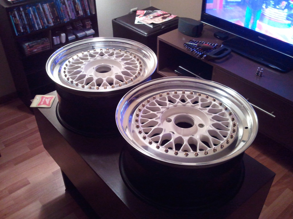

Had the tires taken off on Friday. Apart at my buddy's house and removing the sealant, cleaning them up, and then putting them back together:
Back at my place:
It appeared that the leaks were coming from the barrel side. I didn't really clean them when I got them from Rotiform and the silicone peeled right off of the barrels, which it should not do. It was obvious there was very little adhesion between the silicone and barrel. So we roughed them up pretty good before going back together.
May have gone a little overboard, damn near filled in the whole gap between the lip and barrel, but don't really feel like taking any chances.

I would have thought there would have been a gasket there.
Old Apr 1, 2012 | 08:30 PM
  #45
gilber33's Avatar
Joined: Apr 2008
Posts: 3,948
From: Milwaukee, WI
The silicone is the gasket. That's how they come factory too.
