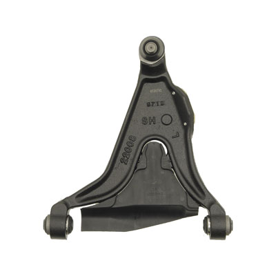

Most cars have stamped steel control arms and the ball joint is one with the arm so the whole thing needs to be replaced (per picture). Price will depend on where you source them. I bought a pair recently at a parts store as I wanted the lifetime warranty, about 95 bucks each. There are only two bolts that hold it to the frame and one pinch bolt that holds it to the bottom of the spindle so it's not a bad "do it yourself" project.
Some have an aluminum arm and the ball joint is replaceable separately. They bolt on so if you get under there and see the bolts you can do just the joint.
You still want to try and find that "whistle" as no ball joint I've ever ran across whistled no matter how worn or badly installed. It might be a scraping noise from the brake pads that goes away when you step on the brakes and apply pressure that takes the "play" out of the caliper and pads. ?? no clue, you need to track that one down.
