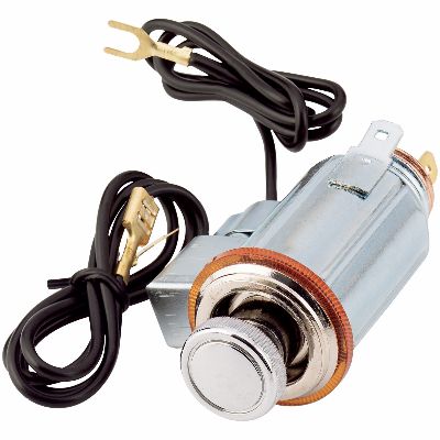

You can pull the radio (aftermarket or stock) and "T" into the hot wire for the radios memory and run a wire from that T down to the cigarette lighter. I think it's a spade connector to the cigarette lighter and if you pull the stock wire and tape up the end you can always return it to "switched" later should you or the next owner want. One scotch lock, two feet of wire and a spade connector and you'd be good.
Or if you wanted a project you could mount an auxiliary outlet ($8-$10 with wire leads) inside the glove box and pull the power from the glove box light switch. Just make sure you're pulling for the hot side of the switch.
Attached Thumbnails Make cigarette lighter socket hot in key off-cigarette-lighter-replacement.jpg
