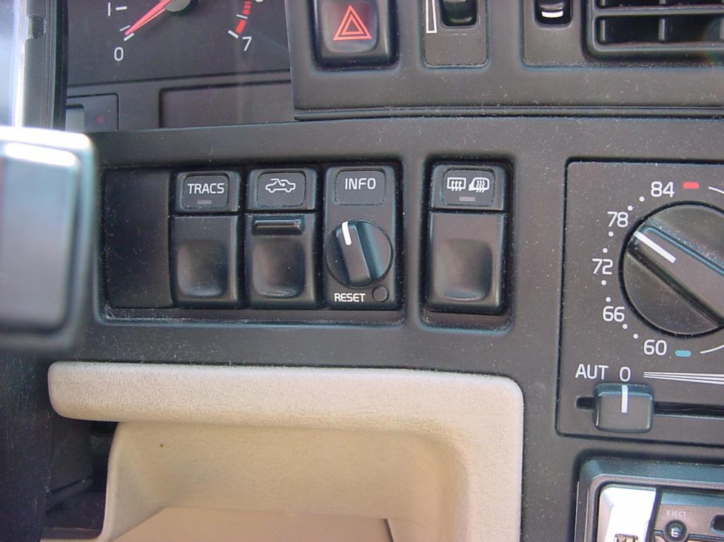

If you get a wheel on ice it will spin and spin and spin and the other wheel will not. That is the big drawback to trying to build a higher horsepower automatic equiped 850. You can get limited slip in the manual but not in the automatic.
If you have the Tracs option it just applies the brake to the spinning wheel and tries to redirect the torque to the "good" wheel. Like ABS in reverse
If you had a problem with getting that drivers axle all the way in you may have unknowingly bent or sheared that retaining C clip. Maybe it never fully seated to begin with.
As for internal damage, it shouldn't have. It's just like spinning on ice. Everything is just freewheeling around with no load on it.
