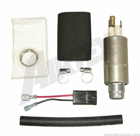

Old Jul 22, 2012 | 09:51 PM
  #26
You need to replace the pump.
most likely problem.
Old Jul 22, 2012 | 10:03 PM
  #27
jrmcgove's Avatar
Joined: May 2008
Posts: 99
Kiss4aFrog, where did you get that image from? Looks like the pump I got from AutoZone today. I wanted to get it from FCP but because it is about $50 cheaper, probably better quality, and I think lifetime warranty. But didn't want to wait for it to ship. Debating on returning AutoZone (AZ) pump and waiting for FCP now. Don't really like how AZ pump fits. First time I put it in, it was sticking out of assembly to far and I couldn't get assembly in the tank all the way. I don't really like how I'm going to have to adjust it to make it fit.
Anyway, any thoughts on qualty of a Walbro pump compared to Bosch? The box it came in says AirTex or AirTek but the pump says Walbro.
Old Jul 22, 2012 | 10:34 PM
  #28
That is the autozone picture. I have a Walbro with a higher output if you're willing to wait for me to ship it. It's the one I was going to put into my 850 once I installed the 19T and the blue injectors. It's more than you need unless you go to a 19 turbo or bigger.
It's similar to the 225 liters per hour pump but a little less volume.
It's equivalent to a E8643 Airtex but it's really a re-branded Walbro and had the Walbro stamp on the body of it. It will supply more than enough fuel for a lightly modified 2.3 and it's what I specked for my modified KKK24 turbo engine.
Pm me if interested.
Old Jul 22, 2012 | 11:54 PM
  #29
for me the warranty if lifetime is worth the wait. I try to source locally but there are things that IPD and FCP have that others don't. The autozone pump isn't a stock pump it's actually an upgrade and it's branded Walbro but it's a bit shy of the 255 LPH pump a lot of the HP guys crave.

Definitely sounds like the pump is shot. So let me get this straight, the pump you had to tap on to get to work was the original one, or the one from Autozone?? Either way, I think I would return the Autozone one and get one that fits properly.
Old Jul 23, 2012 | 10:35 AM
  #31
jrmcgove's Avatar
Joined: May 2008
Posts: 99
Psaboic, yes, the pump I had to tap on was the original one.
