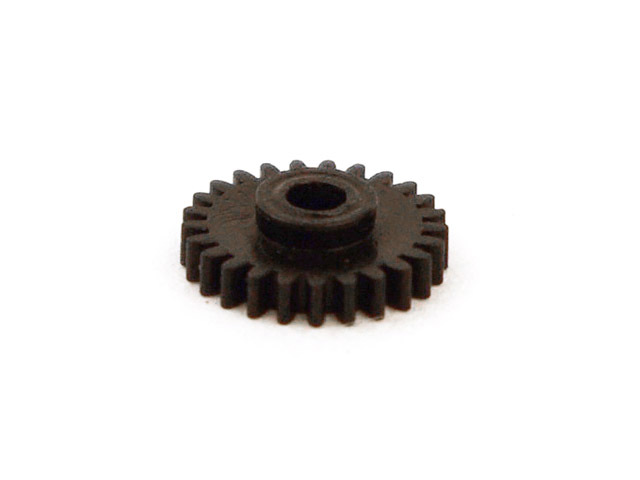

The failure rate on the odometer gears is 100% - it just depends on what mileage they crap out on. I buy my replacement gears from Odometer Gears - WELCOME and I have been quite pleased, none of them has failed since. I do buy both gears and change them both out at the same time.
It is double the money to buy both gears but half the work if you just replace the small gear (which always breaks first) and then have the larger gear fail soon thereafter. Some of my larger gears have been "spongy" when I pulled them out.

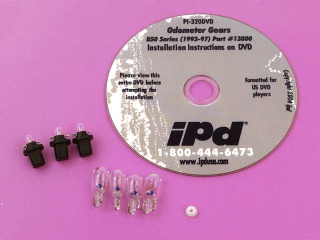

Link to instructions for odometer gear replacement:
http://www.matthewsvolvosite.com/odo...ix-how-to.html
IPDUSA.com sells the gears too.
Attached Thumbnails my dash lights don't work. HELP!-odometer-little-gear-ipd.jpg   my dash lights don't work. HELP!-odometer-big-gear-ipd.jpg
