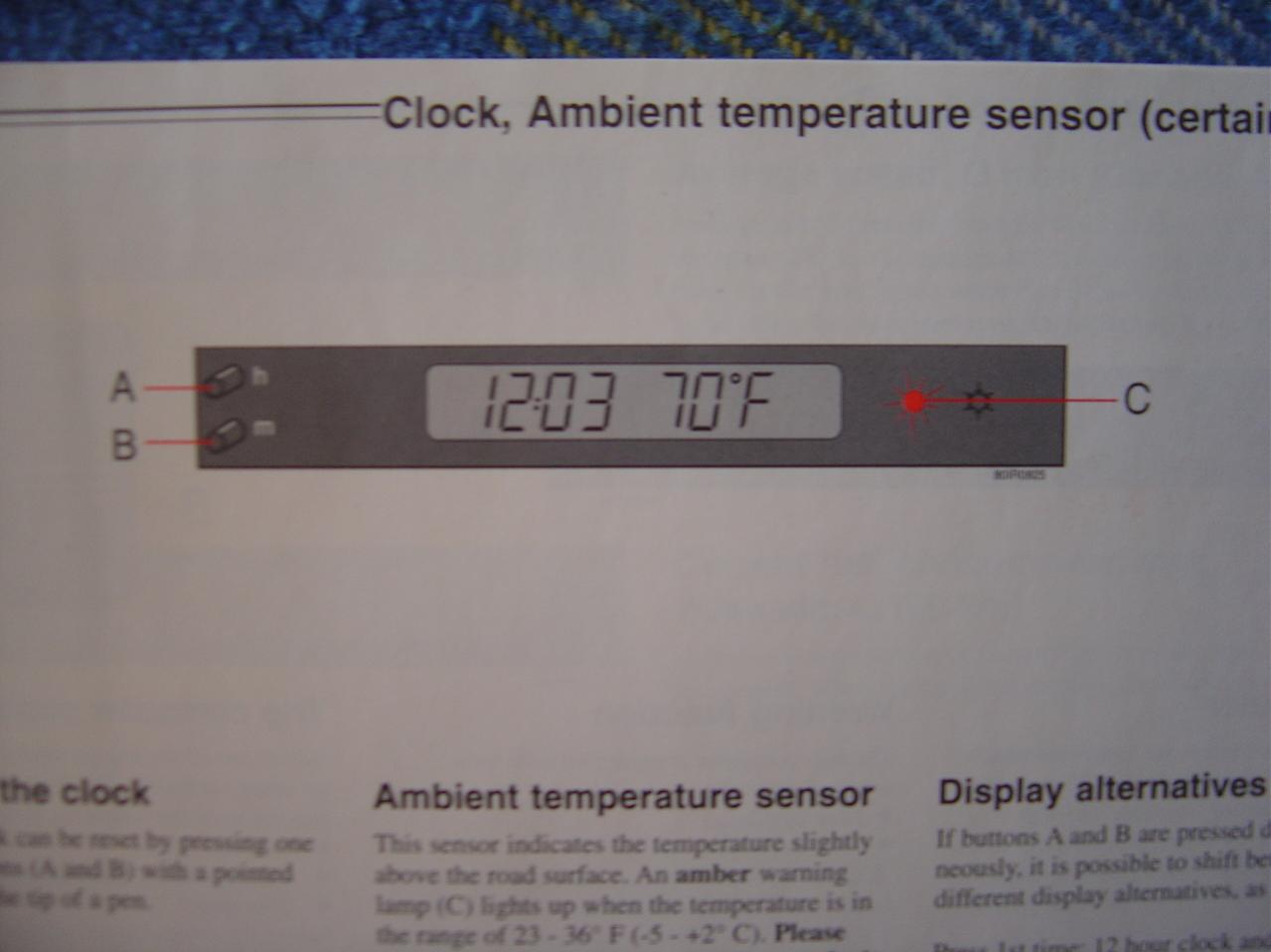

Anyways I found this:
Attached Thumbnails mysterious red light-dsc01864.jpg   mysterious red light-dsc01863.jpg

Snowflake

I was told they don't all have snowflakes, so if it doesn't have the snowflake it could still be that. Is it the same light as shown in the picture?

It's a solitary light beside the display. Similar to the one if the diagram except its not amber. It's red and its the only light there.
