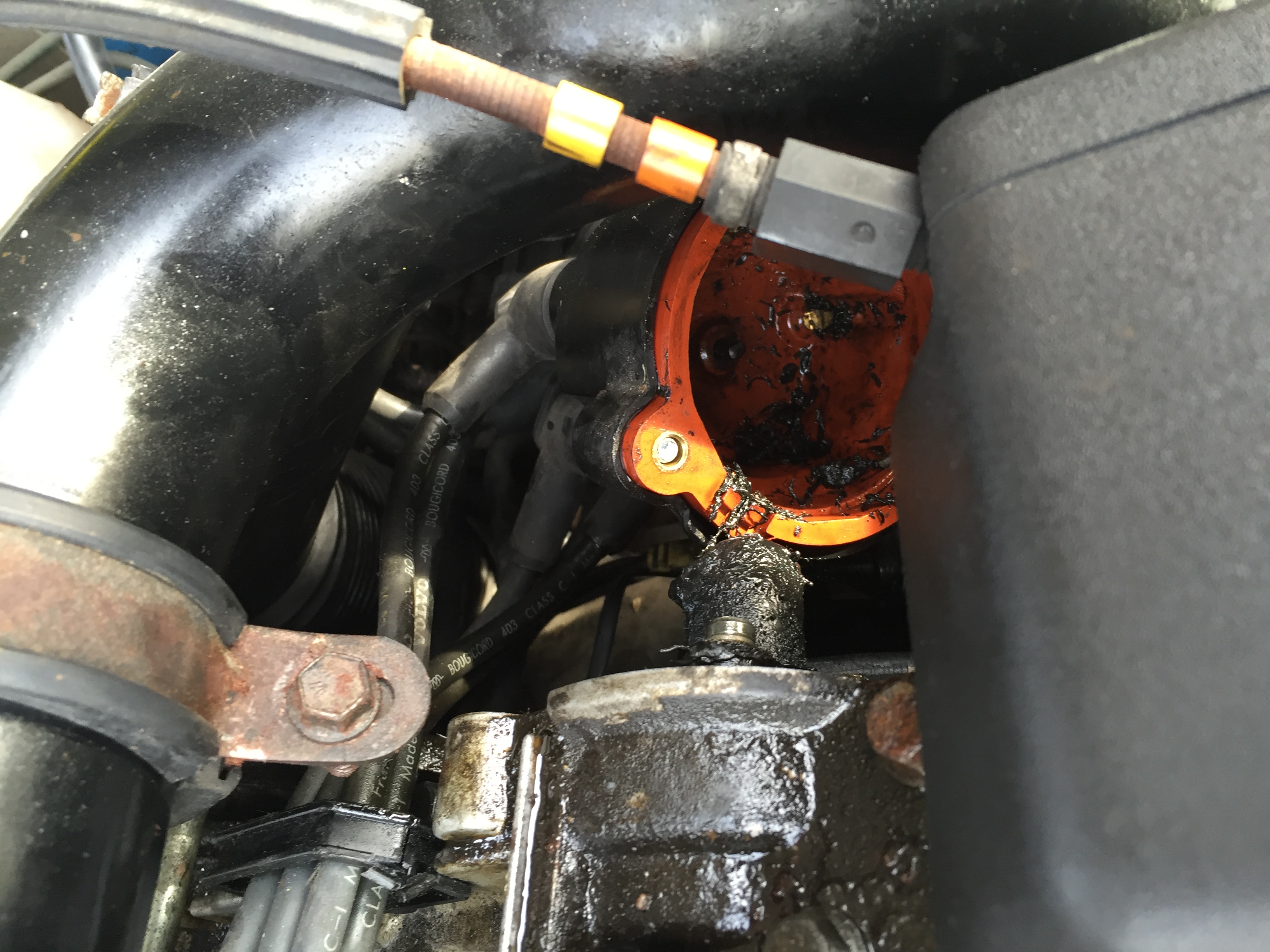

figured out the problem to the no start situation. Destroyed distributor

I was going to suggest checking the spark plug order.

I would suggest looking at the cam seal behind the distributor. I have a car here that the distributor caught on fire internally, due to the oil leak from the cam. Those cam seals walk out over time, and in fact if you just tap it back in it may work fine. New seals for that are about $5, so it's a very cheap fix. I think that is the root problem on your distributor as well. The other cam seal (behind the cam sensor) does the same thing sometimes.

I love the pic of the distributor cap. I also know that the OEM Bosch caps have the plug number stamped on the plastic, and even with that, I've managed to cross wires! What's needed next is a piece of masking tape on side of the engine nearest the timing belt cover marked "#1 Cylinder Here"
Its also a good idea to inspect the wires - I've found wires that looked clean and fresh on the outside only to find corrosion on a connection point.

OP may be lucky, or maybe not..
Has OP considered the blown-up dist rotor (very impressive BTW!) might be a symptom rather than the ultimate problem?
Whatever created so much crankcase pressure that it was pumping oil out of every engine orifice (blowing out the dist cam seal..) is still there I'm guessing.
My guess is a completely clogged PCV coupled with lots of piston blow-by and/or multiple other issues..
