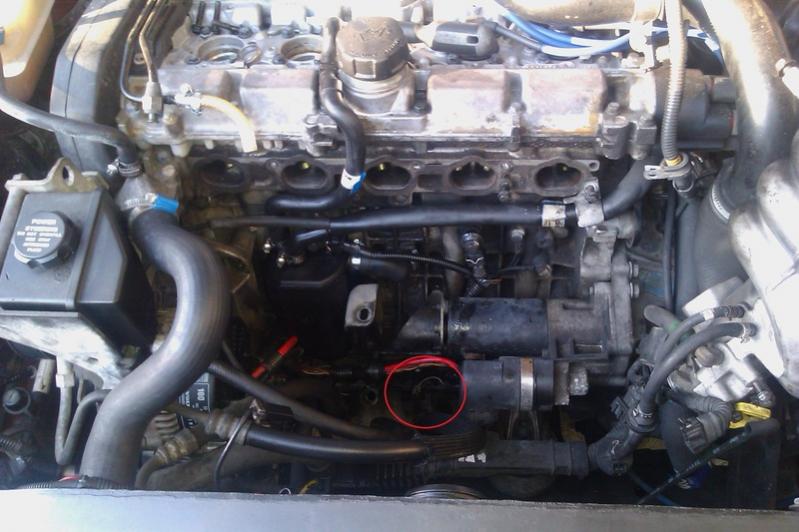

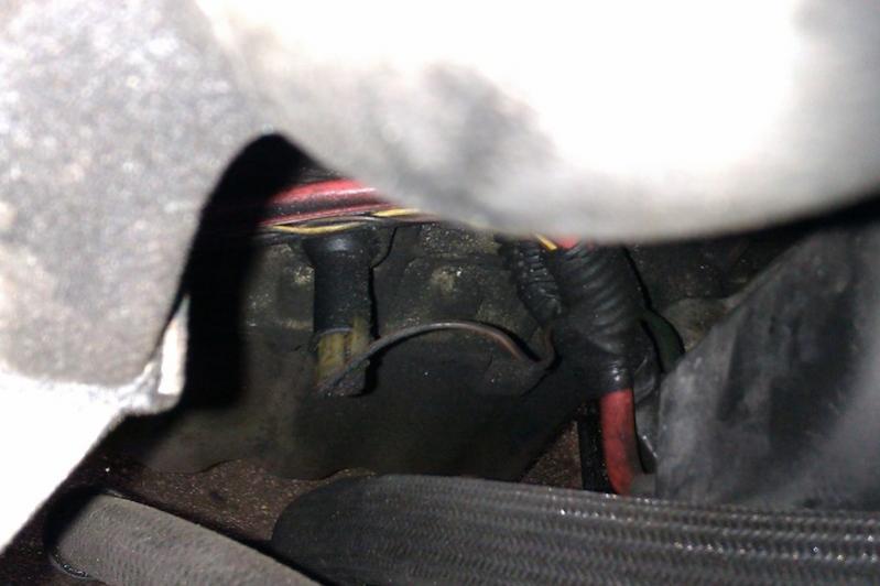

You just need to make sure it fits.
Attached Thumbnails Need an opinion on Glowshift part-oil-pressure-sender-location.jpg   Need an opinion on Glowshift part-oil-pressure-sender-engine.jpg

thanks for the good pics kiss. Can that be reached from the bottom? I ask cause I'm not keen on removing the manifold
Old Mar 18, 2014 | 03:34 PM
I'm pretty sure you can. Not positive, but pretty sure.
