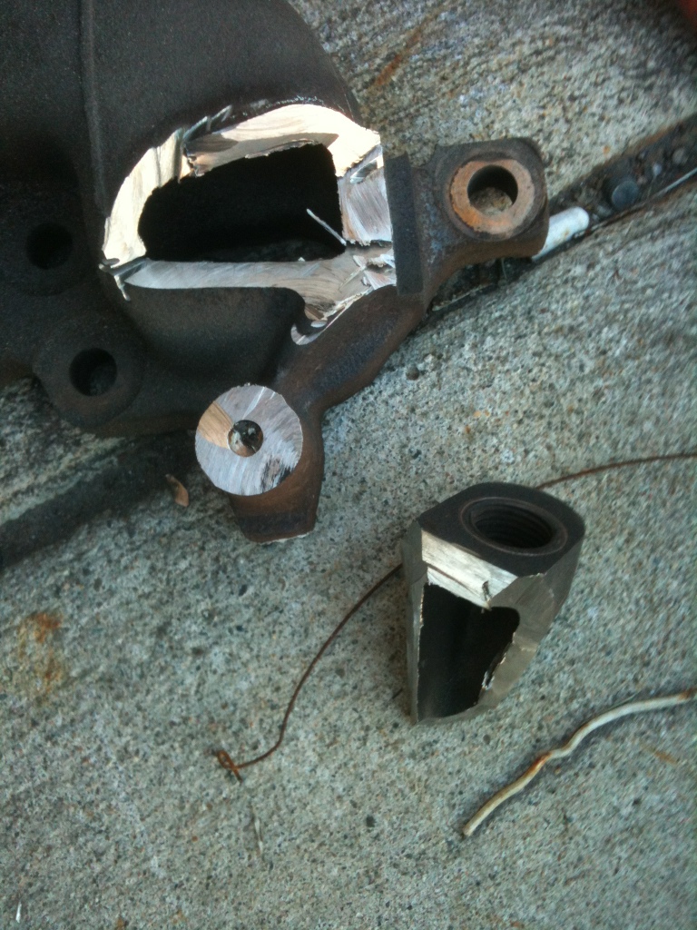

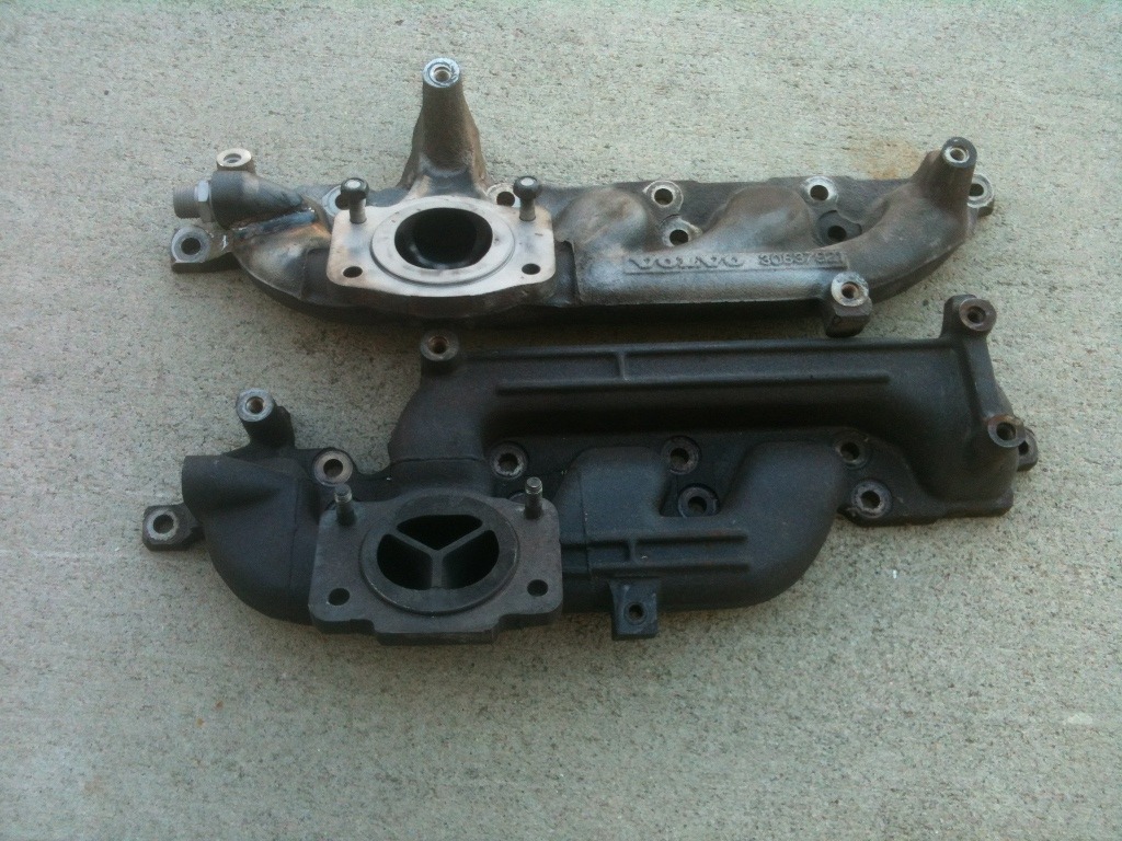

Just do it. Didnt take long and its easy to do.

Whether you have it or not it can be turned off in a tune.
