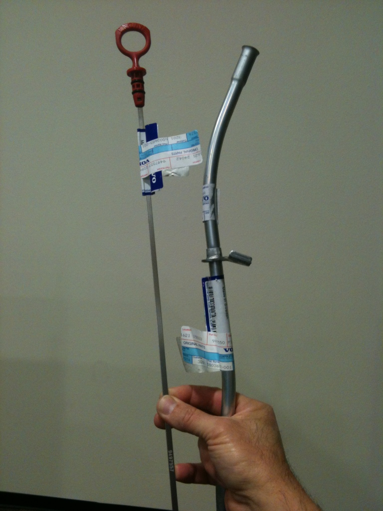

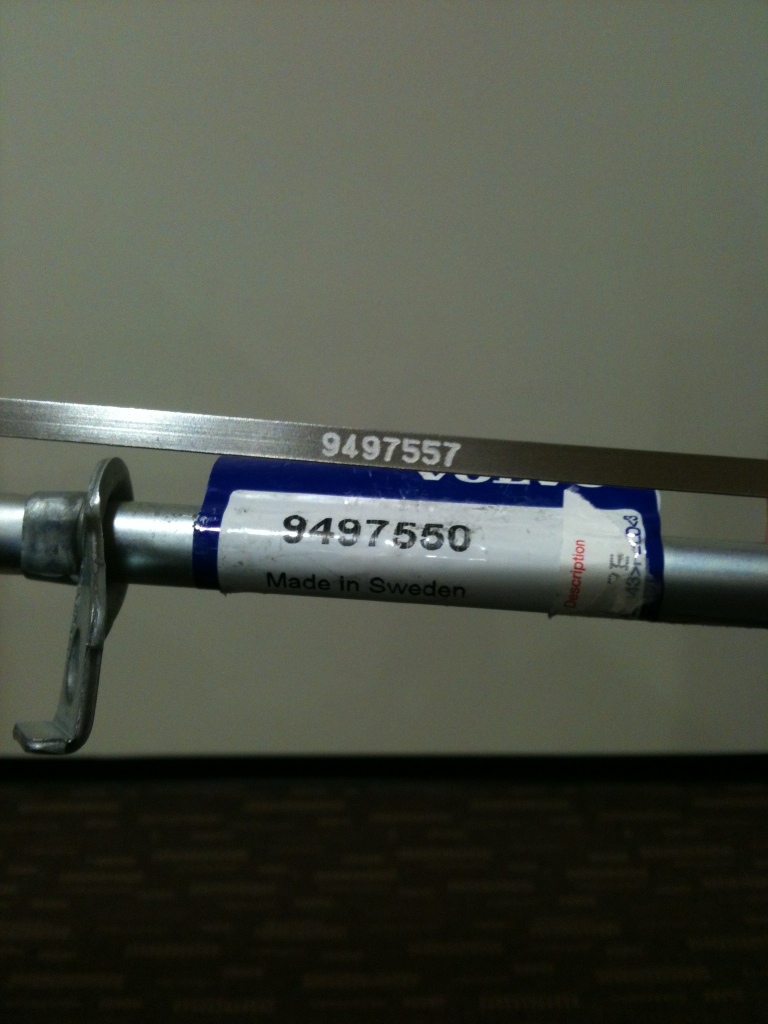

Hello fellow Sacramento'en. The later model dip stick had two o-rings and was flared near the end. The older dip stick in the newer tube will be loose.
Here is the newer style:

well i called the dealer ship and they said i would have to buy a dip stick and tube because they dont make the old dip sticks any more so i figured that the old one is the kind that the 850 has is that nor correct could i just buy the dip stick with 2 oil rings and it would fit?

Its a package deal. You need both of one kind or the other, they are not interchangeable.
Why dont you just go down to Pick N Pull in Rancho and get another one...there are tons of them out there.
