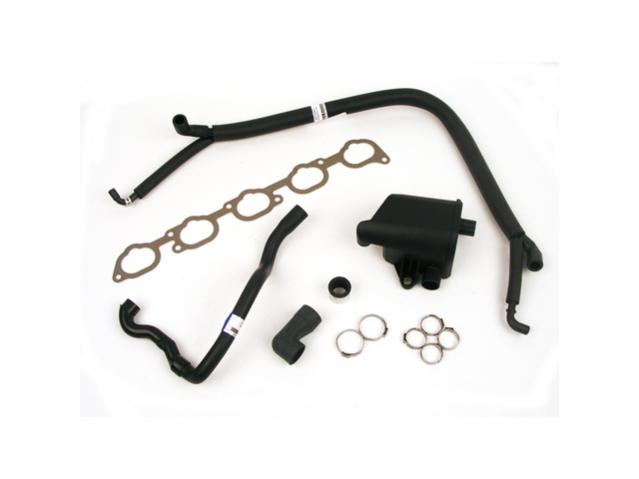

If the engine is really worn you might have an excessive amount of blow by that just can't be handled by the PVC system.
Did you clean out the PTC valve just before the turbo ?? Mine was so bad I had to use a drill bit to etch out the passage from the baked hard carbonized oil that had clogged it.
http://www.matthewsvolvosite.com/for...hp?f=1&t=36184
http://www.matthewsvolvosite.com/for...hp?f=1&t=21995
Did you clean the black box (PCV) or replace it ??
Did you make sure the holes in the block the black box mounts into weren't restricted with crud as most are ?? Tun something in there to make sure they were open ??
How did you test the vacuum lines to make sure they were fully open and not deteriorated/restricted on the inside from the oil and heat ??
Some times it takes a little time for the system to clean itself up. Not sure why that is but others have reported no improvement with a smoking dipsitck right after doing the PCV replacement but had it start working better a while later.
