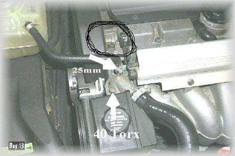

Im getting pooling (see pic with circle) but there seems to be no leakage around the area, thought it might be the camshaft seal since its around the bolt in the pic, but the timing belt cover seems clean in and out. any ideas?

I thought of that, but there is no oil pooing in any other bolt seat (even the ones just below the oil cap, just the farthest one away (the one I circled) strange eh.

Turbo, a mech friend said it might be the bolt it self, if the bolt is loose or worn, could oil under pressure come up thru the bolt hole?
