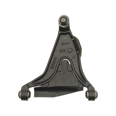

Old Nov 15, 2014 | 10:21 AM
The stamped steel or iron, one piece control arms are just that. You can replace the bushings with Poly or Delrin but the ball joint is built in with no way to replace separately.
You can buy the aluminum control arms if you can find them and they do allow you to replace the ball joints but that's the only way.
Attached Thumbnails one piece controll arm ball joint replacement?-control-arm-lower.jpg   one piece controll arm ball joint replacement?-control-arms-aluminum.jpg

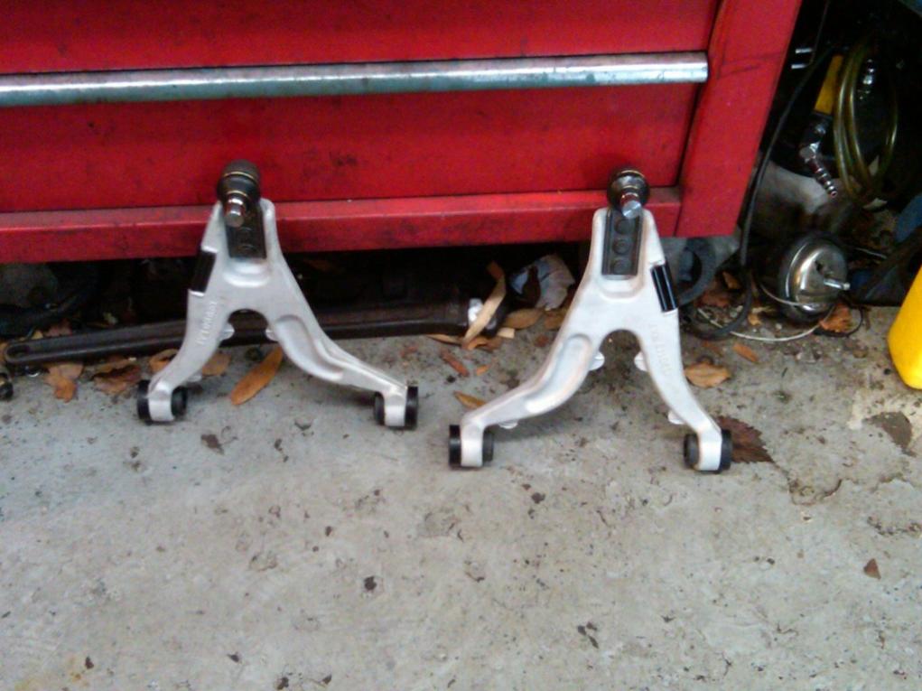

Old Nov 18, 2014 | 01:39 PM
boxpin's Avatar
Joined: May 2009
Posts: 2,702
From: Rocklin, Ca
93 Aluminum Control arms with replaceable Ball joints.

Old Nov 25, 2014 | 10:04 PM
I have them on my '95.
