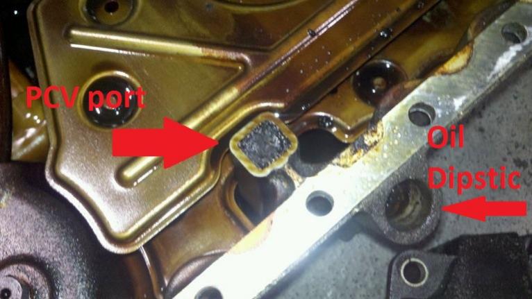

Here is what the black box looks like inside. And the passages in the oil pan that connect to it.
Attached Thumbnails PCV system parts?-pcv-cutaway.jpg   PCV system parts?-pcv-drain-holes.jpg   PCV system parts?-pcv-oil-pan-passage-blocked1.jpg

Yes, those kits are loaded with parts that you really don't need. If you go to FCP's site you can get the following:
- Oil trap box.
- Hose assembly that goes from the box to the throttle body tube.
- Hose that goes to the top of the engine.
- Short hose that connects the side of the box to the block
- Short hose that connects the bottom of the box to the block.
- Associated clamps, 6 total.
Do clean out those ports on the block. I usually drag the sludge out with a large screw, then run a LONG zip tie town the holes to push the rest into the oil pan. Then change the oil to flush out the sludge (so it doesn't get stuck on the oil pick up).
