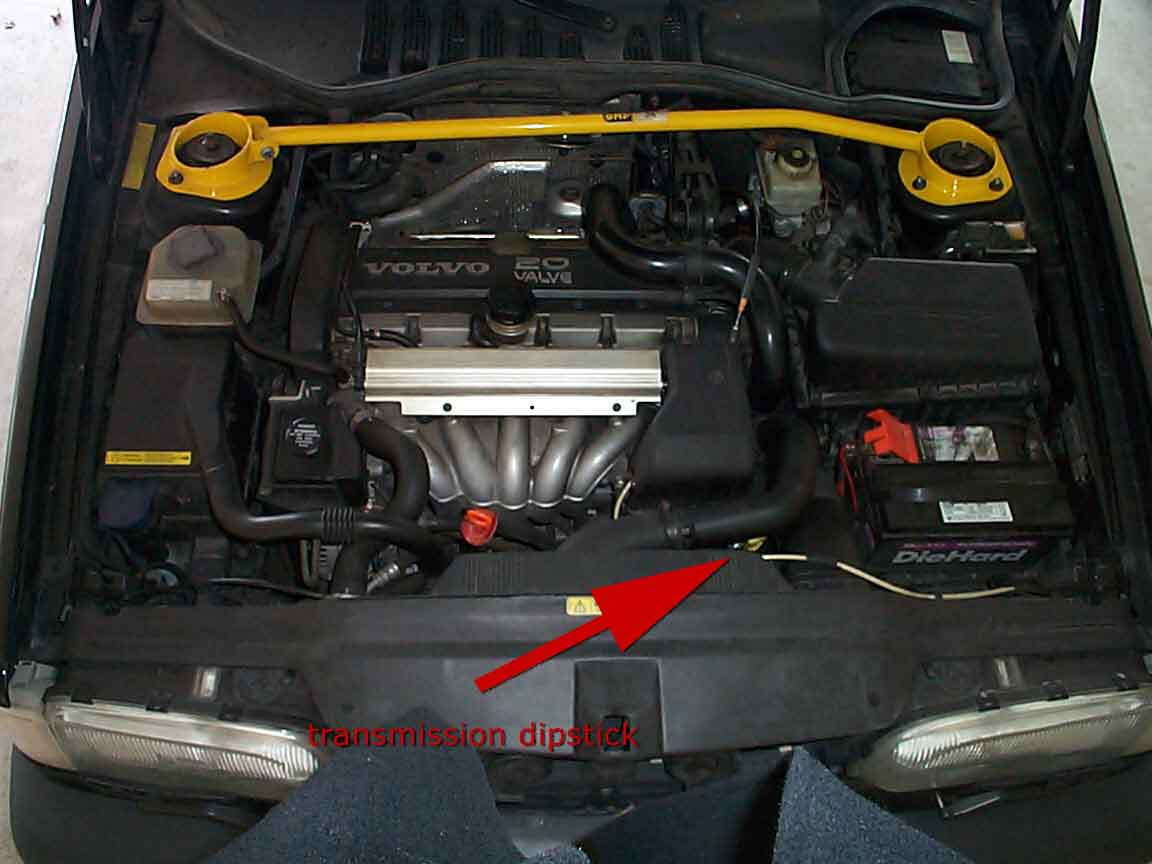

Check the fluid level.
SERVICE INTERVAL
Check fluid level every 10,000 miles.
(More often if you know you have a leak or suspect one)
CHECKING FLUID LEVEL
1) Ensure vehicle is level. Apply parking brake and gear
selector lever to "P" position. Start and idle engine. Move gear
selector lever through all gears, while pausing 4-5 seconds for
engagement at each position.
2) Return gear selector lever to "P" position. Wait 2 minutes
and check fluid level with engine idling. Level should be between MIN
and MAX marks.

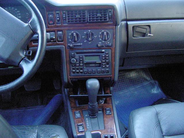

Check the transmission mode switch by the shifter and see if you have it in "Winter" mode. The switch is located a bit further back from the drivers seat heater switch on the drivers side of the shifter in the center console.

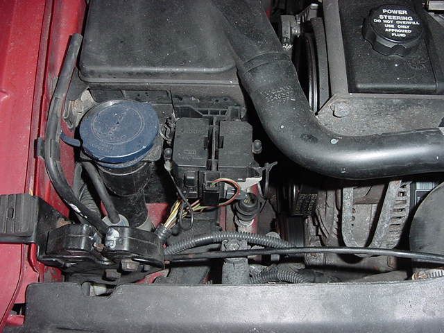

You should be able to read transmission codes by using the under hood diagnostic connector.

Above the winter switch there is a led and it is blinking green. I don't know if it is indicating i am in winter mode or not. And can I still do what you told me without using the E brake, because i believe the E brake does not work. Somebody told me to check the fluid for the transmission before the engine gets to hot so I can accurately check it. Is that true?
On a 93 you should have an under hood diagnostic panel you can use to pull trouble codes. There isn't a code reader you can just plug in like on a newer vehicle. Or .... sure you can take it to the dealer.

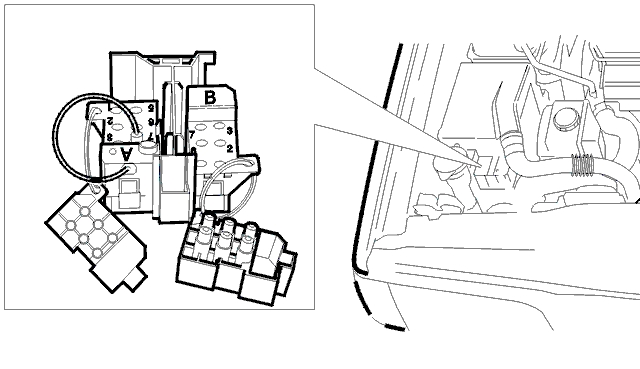

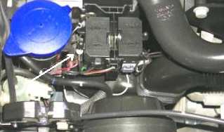

To start, the Ignition key must be in position II, engine not running. Open the hood. Locate the two diagnostic sockets just inboard of the washer fill cap. The “A” connector (shown above) has a jumper that is stored in the lid of the “A” diagnostic connector. The jumper is used for both diagnostic connectors.
What Codes You Can Get
Listed below is the information retrievable from the various connections.
Normally “Check Engine Light” information will be found in A2. Put the jumper into A2 and push the black button for one second. Count the red LED light as it blinks back information, blink, blink, pause, blink, blink, blink, pause, blink, blink, is an example of the response you would receive. 2-3-2 would be the code retrieved, now push the button again for one second, again count the blinks, keep checking for codes until one of them repeats, this means you have read all the codes.
full instructions
http://www.matthewsvolvosite.com/read-codes-volvo-850
