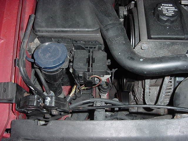

I can't help with your question but in case someone is looking for how to do it on an older model with the self diagnostic panel this should work. I searched high and low to come across it when doing my broken odometer gears. If I see the VIDA info I'll post it.
As long as you have the DTC boxes up under the hood ('93-'95).
1. Switch ignition on
2. Connect the fly wire to socket - A7
3. Push button 5 times
4. When LED comes on and stays on, enter code 1-1-1 as follows:
- press the button once when LED is still on
- wait for LED to go out and come on again
- read off response, which will be the last three digits of the odometer miles
5. Repeat steps #3-4, but enter code 1-1-2 (that is, press the button twice on the last step); read off the response, which will be the first three digits of the odometer miles. If you have less than 100,000 miles, the first digit will read as 10 blinks.

I tried this method and it worked. Having just fixed my odometer gear, I was only guessing what the car's total mileage was.
Thanks.
