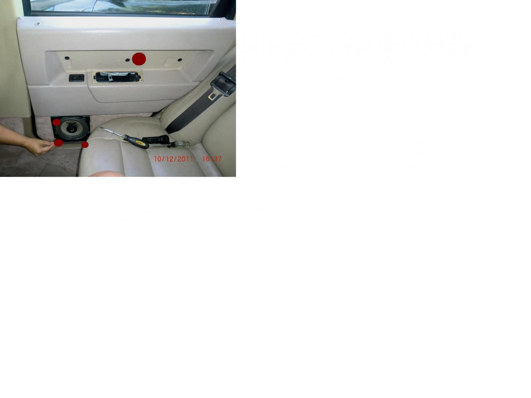

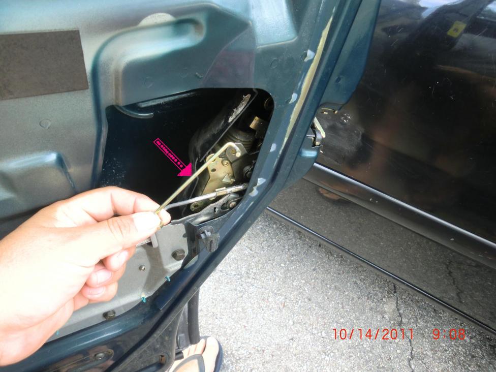

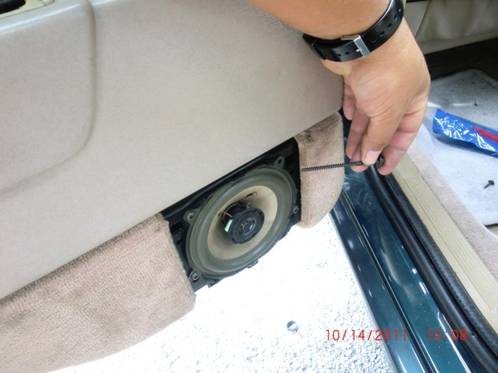

Finally I could release my rear doors weeks ago. I did not need to remove the back seat luckily. I found out a connector/hook wire was missing on both doors and put it back here you have the pics.
