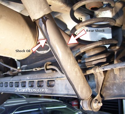

hey guys l went to mavis discount tires for a tire balance.beware, those guys tried to rip me off.l flushed my power steering fluid with a clear good fluid like a week ago. my fluid is clear as water now. they told me my power steering fluid needs to be changed because it was contaminated and looks black and l told them no thank you l changed it a week ago.LOL. afterwards they told me my rear shocks were leaking. is there any visible signs of leaks that can be seen on the rear shocks because l know my shocks are still in good shape.
Old Jan 17, 2012 | 12:39 PM
You can drive around a week or so then look at them. If you see fluid on the shaft, maybe they are leaking. If not, keep driving. When your shocks get bad, you will feel them get bouncy or to stiff.
Old Jan 17, 2012 | 01:26 PM
What fluid is it you used that is clear in the power steering ??
If you just used regular "Power Steering Fluid" that wouldn't be the right fluid for your Volvo. Volvo specifies automatic transmission fluid which would have a pink color to it. Mine says to use ATF "Type F". It might not make a difference but then again it might not be compatible with the seals in the pump or rack and could cause you some trouble in the future with leaks or excessive steering effort.
Either way it shouldn't be black in a week and still be working so they likely were just trying to sell a flush.
If the shocks are leaking they will seep oil past the seal for the shaft and down the outside of the shock.

like Kiss4afrog said, the oil leaks out of the shock & runs down the side. I drove my 850 for about a year with a bad shock, didn't bother me what so ever & I didn't notice it until the car was on the lift for the annual inspection.
