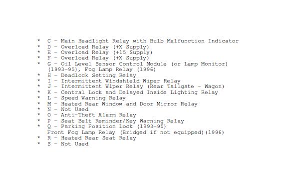

Half of them are way far up under where the hood-pop handle is.... and I mean like way up there.
The rest are under the fuse box. You need to remove the screws on the fuse box to get to them.
Here are some pics that are like Yahtzee to you.
