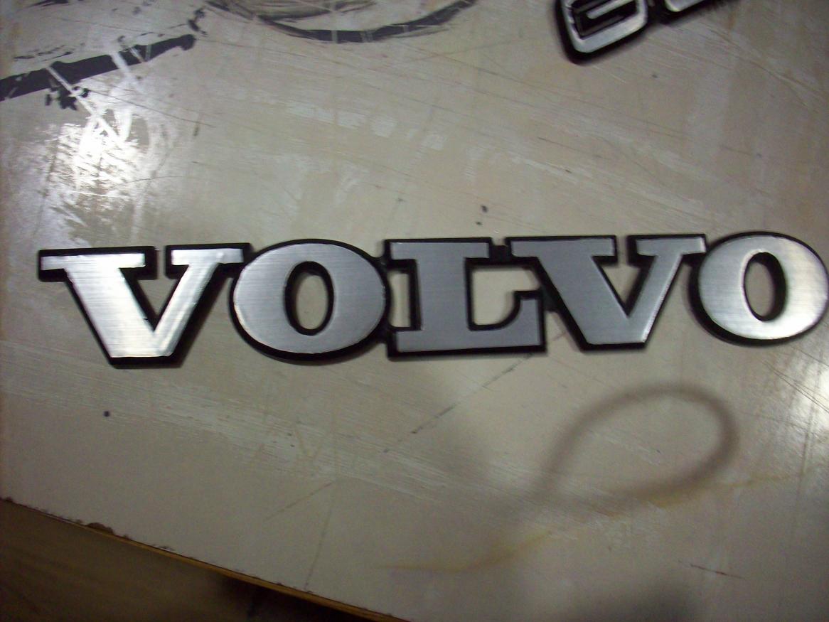

I bought a strip of brushed aluminium vinyl sticker from a sign writer for $6. As you can see with some careful cutting it could look quite good. Unfortunately the "o" is difficult to cut so I scrapped the idea. I hunted down the font called Volta, but can't find it in Word, so I cut and pasted a badge into a document and fiddled with it until it was the right size. My plan was to cut each letter out before sticking it to the car. To do this I need to buy a better knife. If it works I will upload the template for others to use.

Sorry about the blurry pic. Try this one.
Old May 27, 2013 | 06:24 AM
bigdannyoh's Avatar
Joined: May 2013
Posts: 26
Stupic computer.... Try this one!

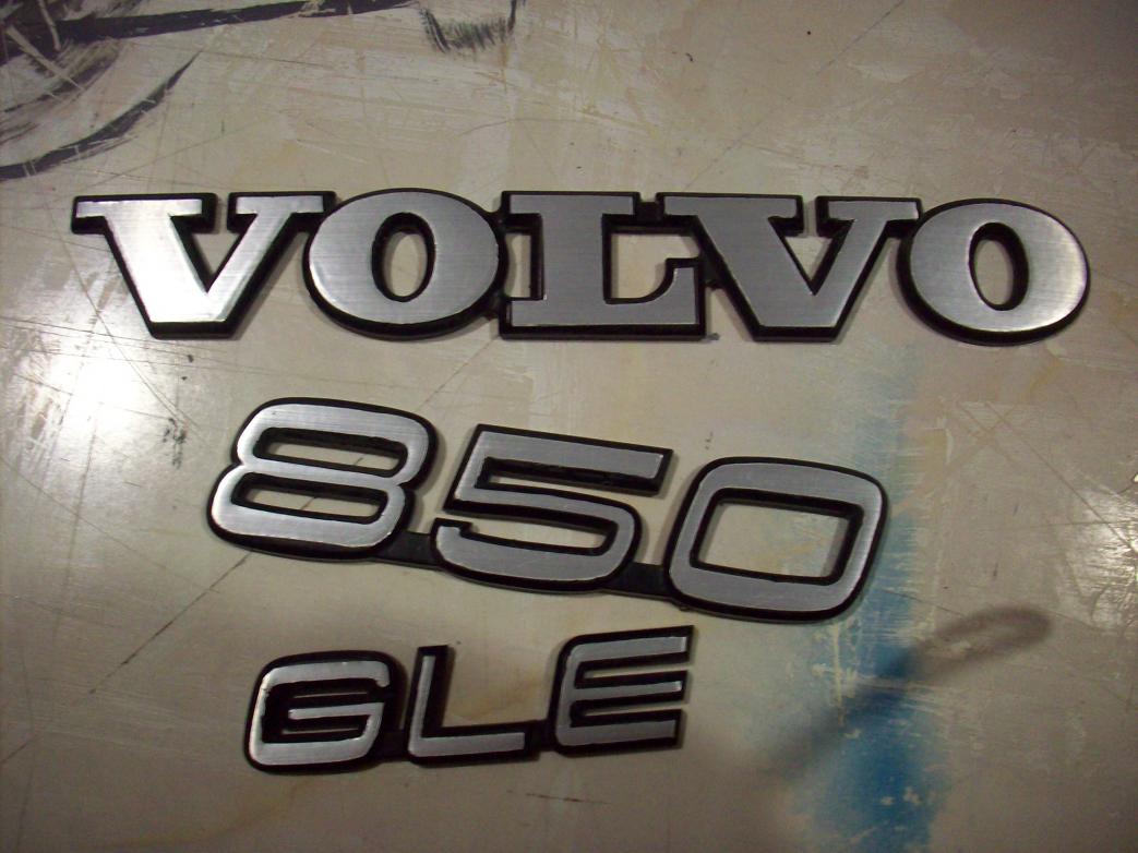

Thanks for all the comments and opinions. It is really interesting to hear what methods have been used. I am going with the vinyl method but in the process removed the badges to allow for more careful cutting. Once off I was able to polish the surface of the car. My paint was very good with no shadow so I could leave it de badged if I want. I then rubbed the badge surface with OOO steel wool to remove the remaining silver. Now the badges are matt black and look pretty neat so I could just use them or repaint with black gloss. I decided to perservere with the vinyl and I am actually quite happy with the result. It is something you get better at the more letters you cut. What do you think? I will let you know if it peels etc. Oh, by the way, I also bought a new badge on the net but it turned out to be for a wagon. It is bigger than the sedan. Anyone want it?

Just finished the minor badges. I went around the edges with a fine file so there is no lip to catch. Tomorrow it goes on the car.

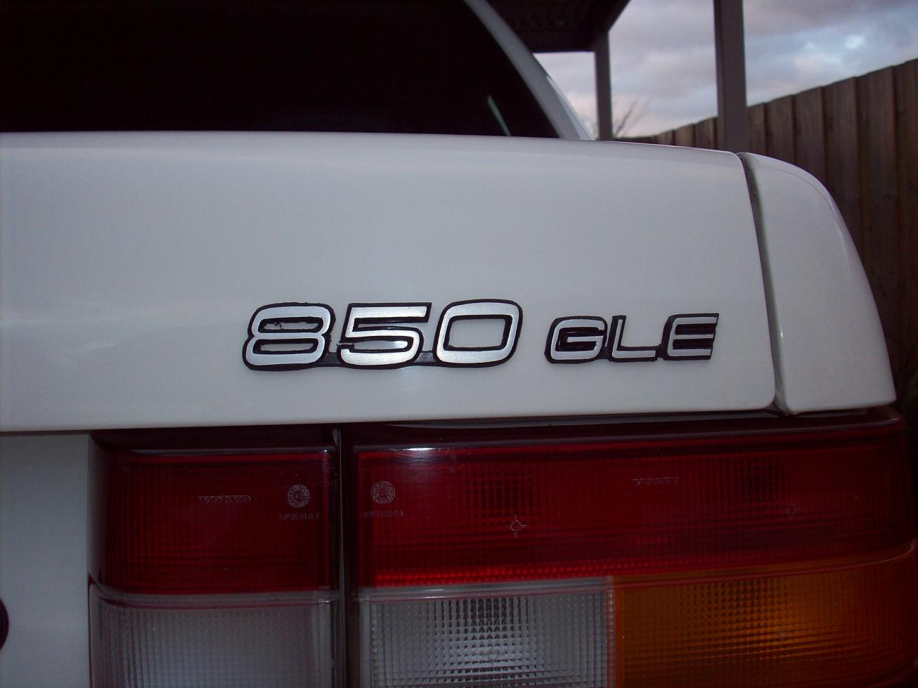

Job done. Pretty good I reckon! I sprayed it with clear enamel to better seal the edges. If it doesn't work there are always the other options.
Attached Thumbnails Restoring silver badges-110_1185.jpg   Restoring silver badges-110_1186.jpg

They look great. Hope is stays.
