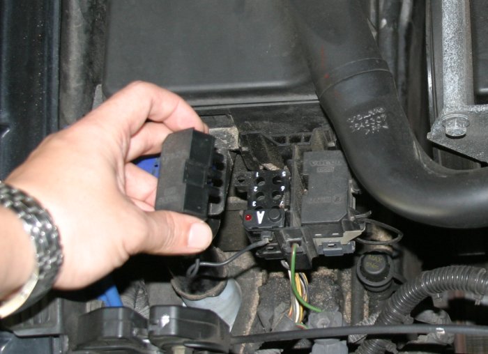

No, you have to reset it with the OBD-I port near the ECU box behind the right headlight. There are instructions in the DIY Sticky.
Old Feb 12, 2012 | 10:33 PM
The panel next to the washer fluid reservoir filler.

1 button press wait for light
4 (count thoushand) same as above
1 (count) ditto
5 (thos) ditto
1 (press) ditto
light should flicker.
14151 is the code
make sure key is in #2 position if it dosn't take try again
