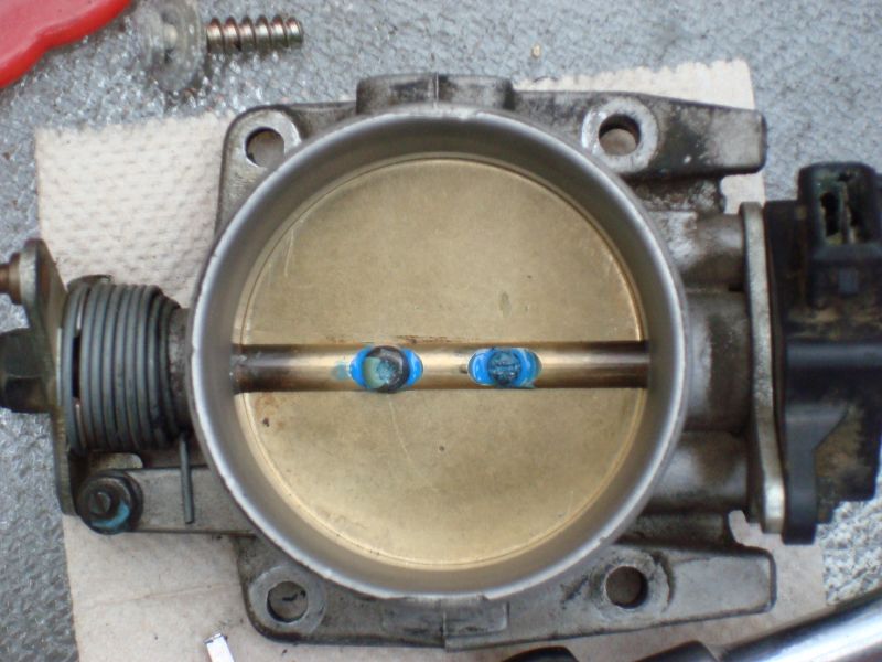

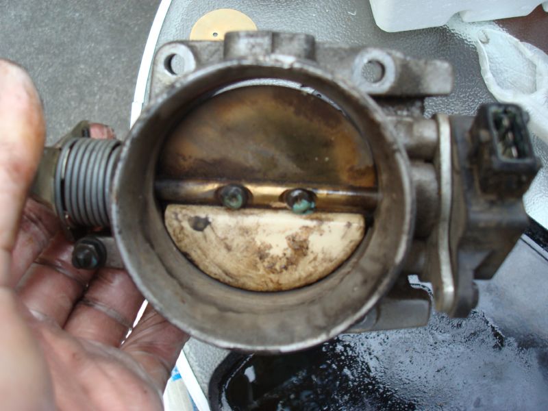

If it only happens at first I'm going with gummed up thorttle. First picture isn't really all that bad but you want to clean it so it looks like the second. Make sure you use a product that is for the throttle body. Do NOT use carb cleaner. It can damage the coating on the throttle plate.
