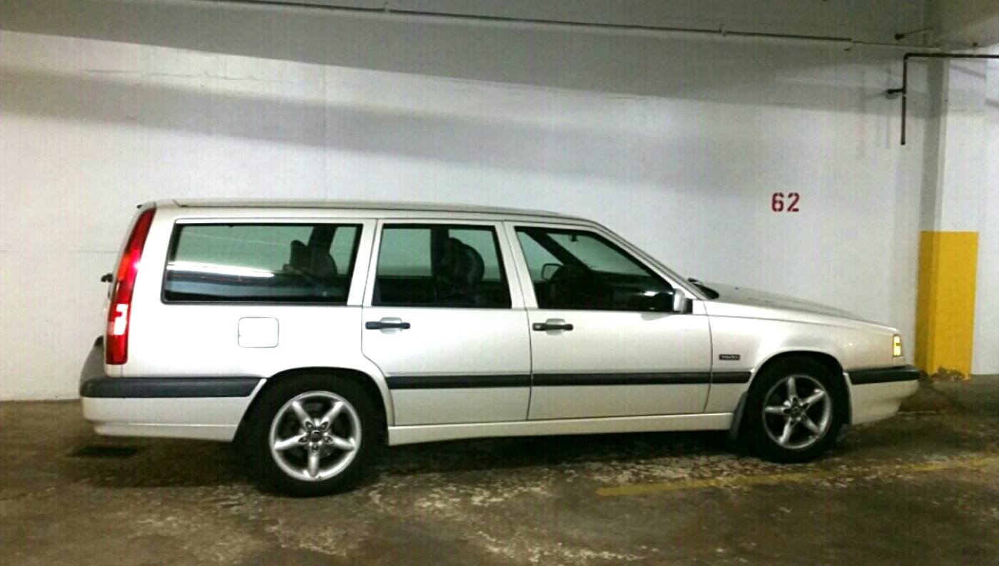

new here, just picked up my Platinum this summer. suspension feels soft...some nose diving while braking hard and lots of leaning. wondering if you guys think my car has been lowered, or if this might be stock height? trying to put a plan together for mods this winter.

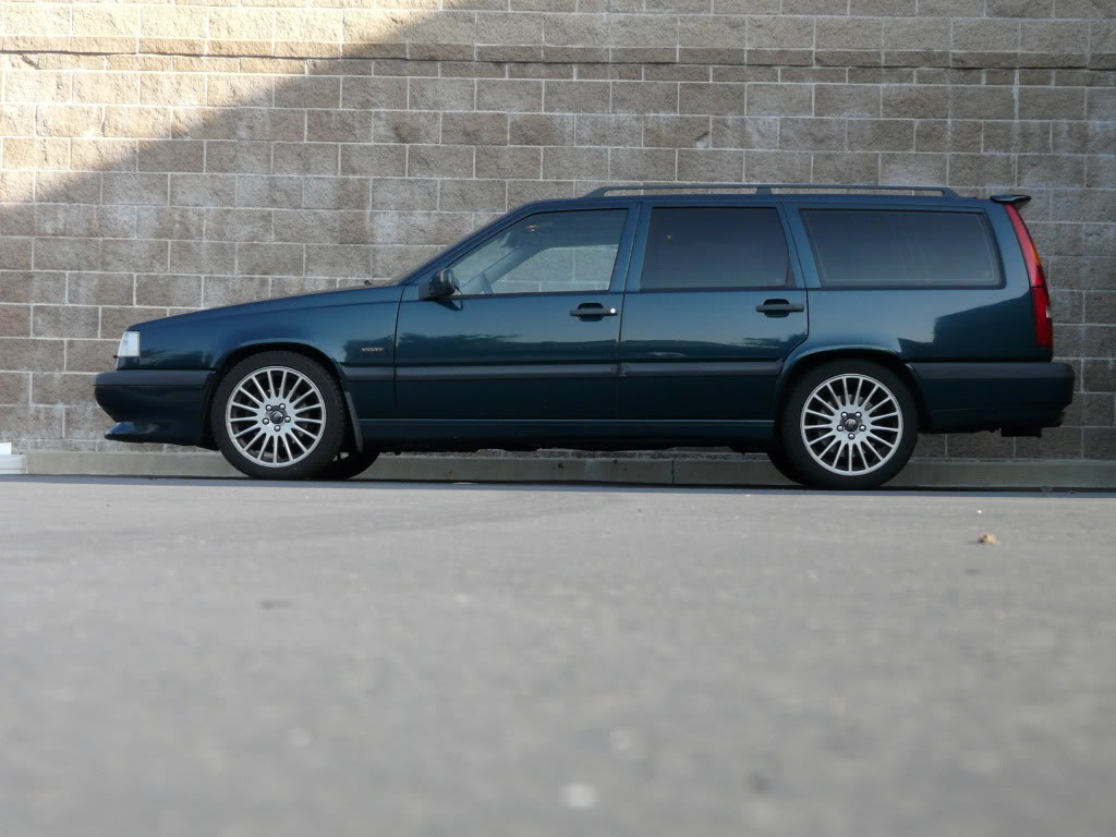

Here is my car at stock height before lowering.

Here's a pic of my platinum after putting on new Bilstein TCs and stock springs on the rear (Nivomat "conversion"). Since I'm new to doing any suspension work, what is the benefit of "upgrading" to 17" wheels from the 16" Persus, other than the fact that they look better (in my opinion, anyway). I assume that you're shooting for the same diameter of tire? Again, this is new to me, don't mean to start any arguments, lol.
Old Oct 26, 2015 | 08:08 PM
platinum20v's Avatar
Joined: Oct 2015
going up an inch in wheel size, usually means less sidewall flex for better handling. How's the ride with your setup?
Old Oct 26, 2015 | 10:57 PM
Jazzer's Avatar
Joined: Apr 2015
Posts: 18
The ride is definitely better than it was; previous owner had Sensen brand shocks and struts, but kept the original rear springs from the Nivomat suspension. It was nearly bottoming out in the rear. Now that I fixed that, all I notice is the sloppy front end. So eventually I'll get some Bilstein TCs on the front, and perhaps some lowering springs all around, once winter is over. Wife won't let me spend too much at once lol.
