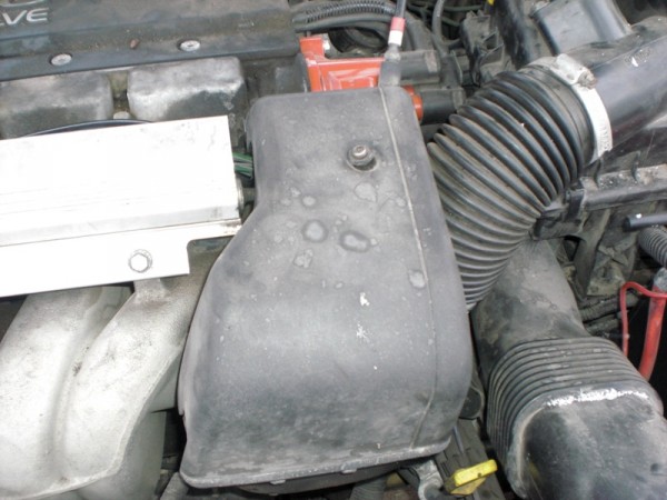

I don't know if this could be an issue but should something be plugged into the connector on the left in this picture.

Lol, no, just a cap. But neither should that jump wire. Pull that wire out and let it hang until you get the cap that goes there. I have one if you would like it. Just pm me.

That is the diagnostic panel for reading codes. The wire shouldn't be plugged in unless you're using it to read them. It normally stores in the cover as shown in the picture of the cover in the hand. Use something to keep it covered to keep dirt and moisture out until you can get a cover for it.
There was a cover laying next to it. So the wire is only put in the when you read codes? Are you saying there are codes that are read at that block some how or do you step the wire through the various connections on the block and then use the code reader at the OBD11 inside?
