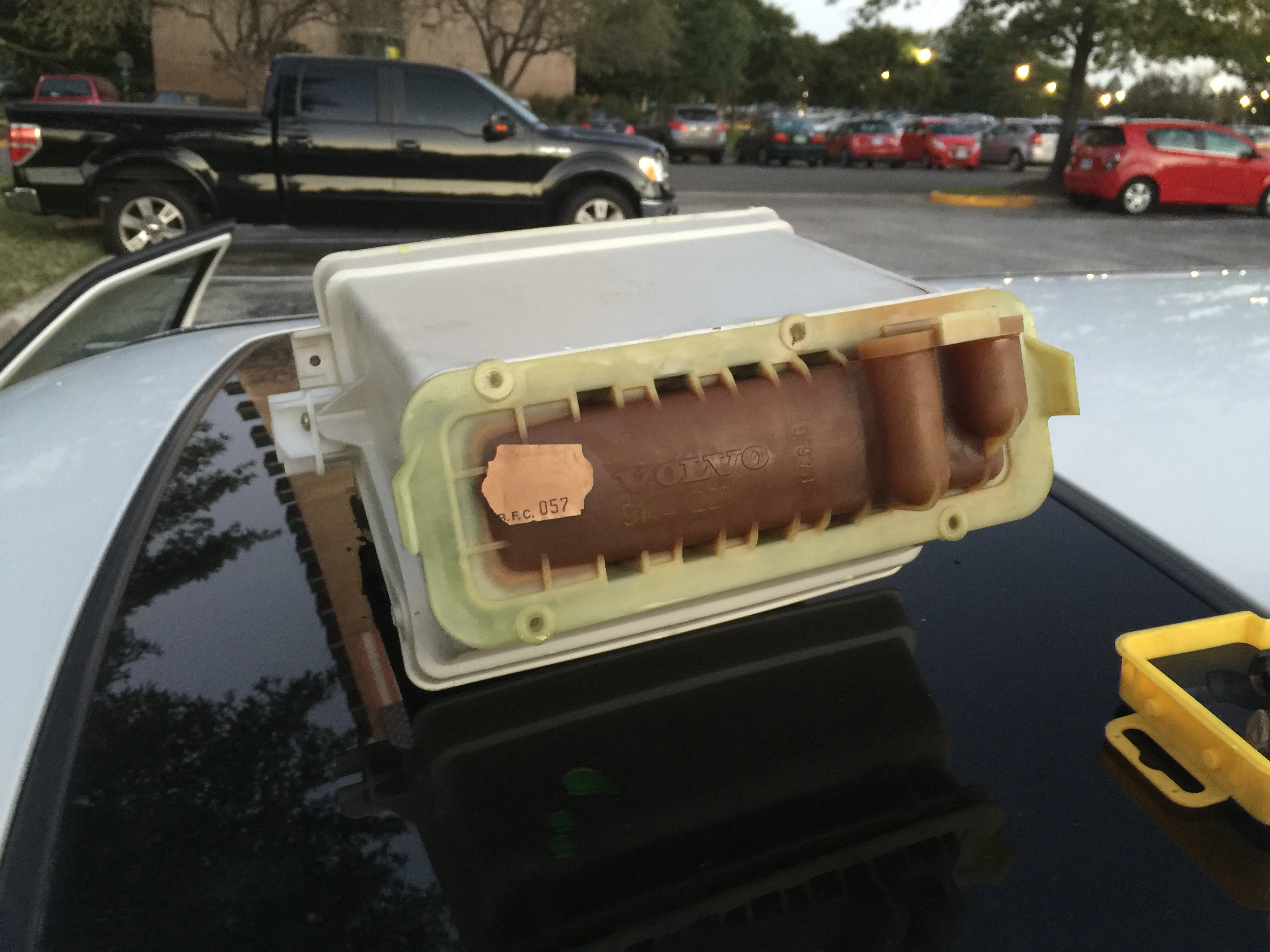

Decided to get mine knocked out tonight. It was leaking where the plastic meets the radiator portion. Now how the heck am I going to clean these carpets...
