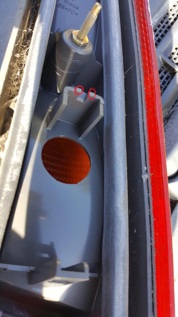

Old Oct 11, 2016 | 09:04 PM
Phil 850's Avatar
Joined: Jun 2012
Posts: 472
Picture 1 is the old and new tail light lens.
Picture 2 has a red circle around two tabs on the old lens. The newer lens had much larger tabs and if anyone is doing this trim the larger tabs down so the lamp holder will snap in place. If you don't trim those it makes it impossible to get the lamp holder to snap in.
Attached Thumbnails Tail light lens question-20161009_152420.jpg   Tail light lens question-20161009_152454.jpg
