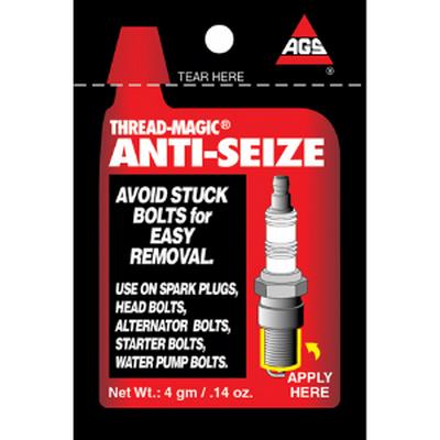

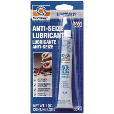

Real good idea to replace the torx bolts with hex heads. And a little anti-seize wouldn't hurt either.
Attached Thumbnails thermostat coolant temp sensor-anti-seize-packet.jpg   thermostat coolant temp sensor-anti-seize-tube.jpg   thermostat coolant temp sensor-anti-seize-jar.jpg
