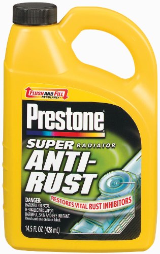

I don't have a reason for it but I'm not a big believer in the "fail safe" thermostats. For an 850 at least, the thermostat is easy enough to do and they are relatively cheap. I do a thermostat when I first get a car, that and every three to five years when you change out the coolant I do a thermostat. I do add a bottle of conditioner or "water pump lube" yearly to control rust and the solution getting too acidic. I just haven't had a problem with a thermostat yet.
Attached Thumbnails The thermostats we install...-cooling-system-anti-rust-prestone.jpg
