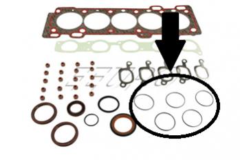

Per the above answer are you noticing oil coming from the oil cap and soaking the valve cover ??
If you do it can be a bad gasket or a sign the PCV system is redistricted or clogged. The glove test will tell you if there is pressure pushing the oil out or not. If it's pressurized even a new cap gasket won't help.
If it's noticeable from the oil filler cap you likely have worn plug wires too In good shape they should seal the spark plug tube form moisture and oil.
If you don't notice and leakage for the oil fill cap it's possible you have a leak between sections of the "valve cover" and head. It's not really a valve cover but if you look at a parts diagram you'll see the sections of the cam carrier and how it might leak. It's much more likely that on this engine it's seeping down the tube rather then seeping laterally into the tube between the castings. BUT , , , that can happen and you'd have to take it apart and replace the "O" rings. There is no "valve cover gasket" as most of us understand it.
Volvo Cylinder Head Gasket Set - eEuro Kits 102K10075 - Free Shipping
Attached Thumbnails Top of the engine too ya!-headgasket-set-plug-tube-o-rings.jpg
