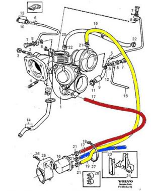

This is a mbc very simple to install.

Here is the factory bcs

Update
I replaced the vac lines and, as per the diagram, I found the green and yellow lines reversed. Put them in the right order and everything works as it should now. Thanks for all the input on this.
