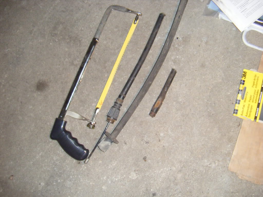

And did the passenger side e-brake today. New everything. Was hoping to get the driver's side done as well, but being my first time and then realizing that the shoes or the cables have never been replaced before, the passenger side cable had broken at the mount after it comes out of the car, not allowing me to move the inner-cable to undo it from the e-brake mechanism, so I had to cut if off. I eventually got it, but it took longer than hoping.

And the old....really really old.
