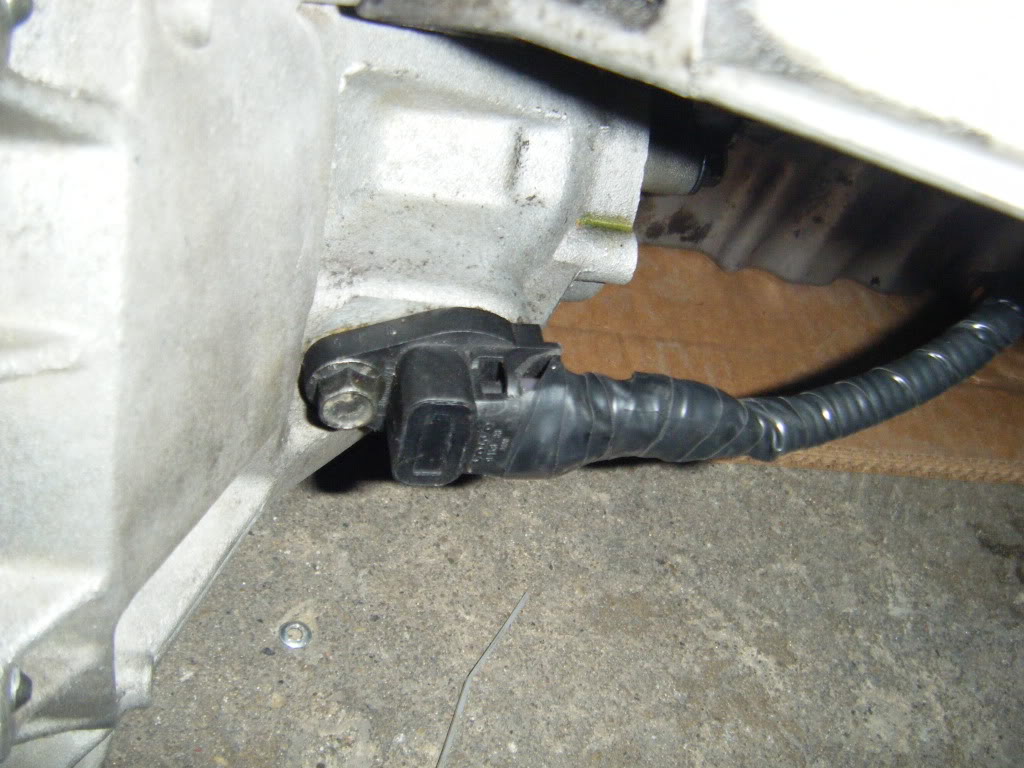

Reverse light plug
speed sensor plug

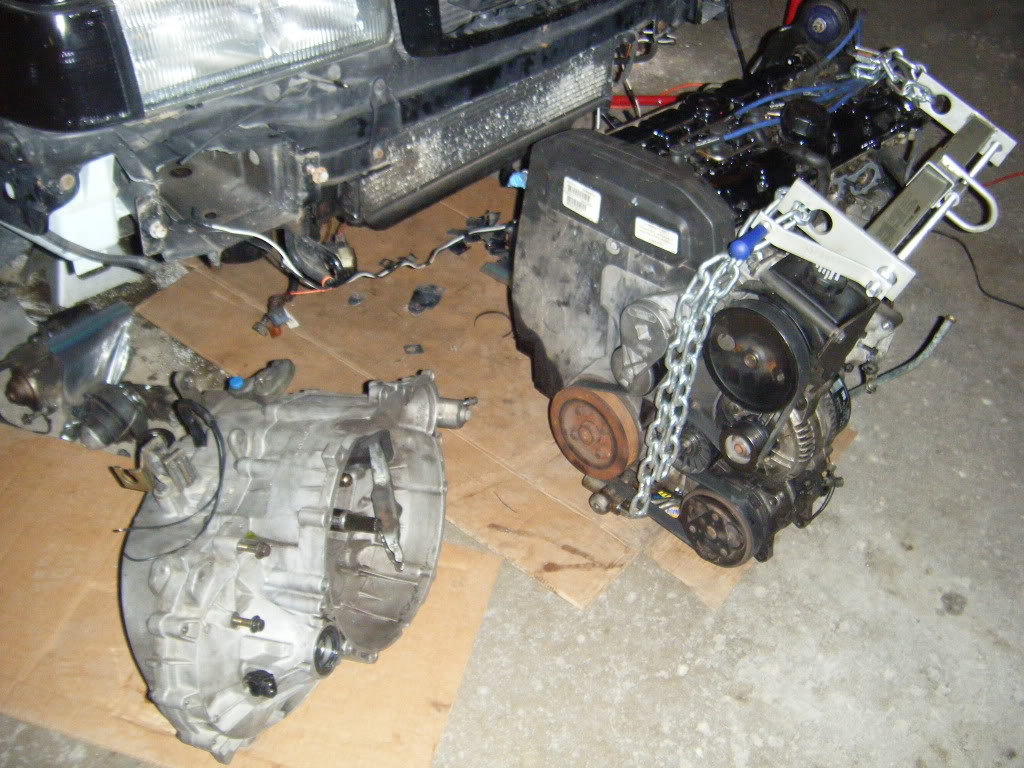

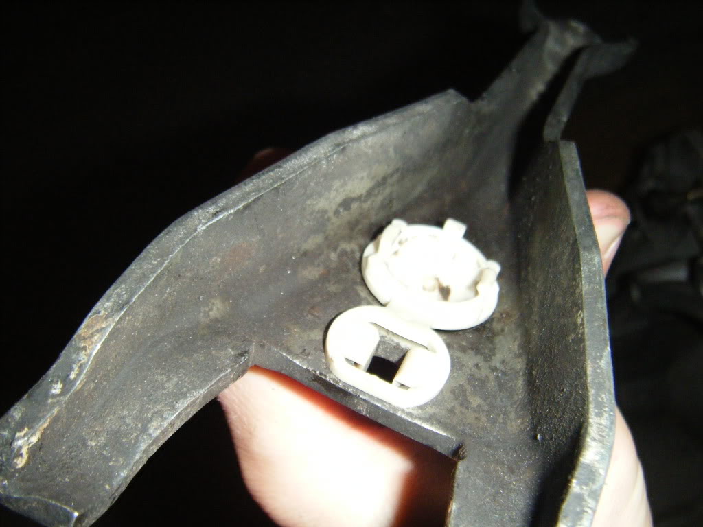

Transmission back off to put in pivot pin ball seat

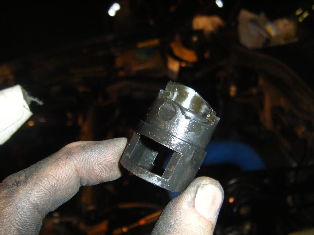

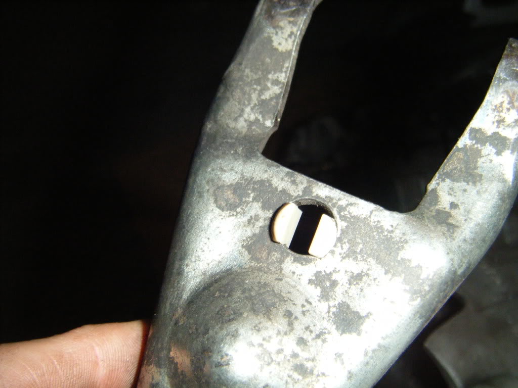

Ball seat; this is what allows further travel of the shifter fork as Dongle's video explained

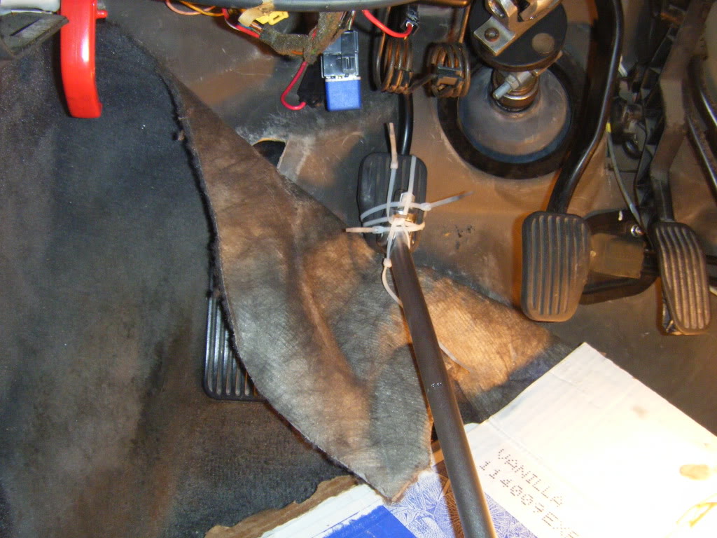

My special tool I made when I tried to bleed the clutch by myself. lol

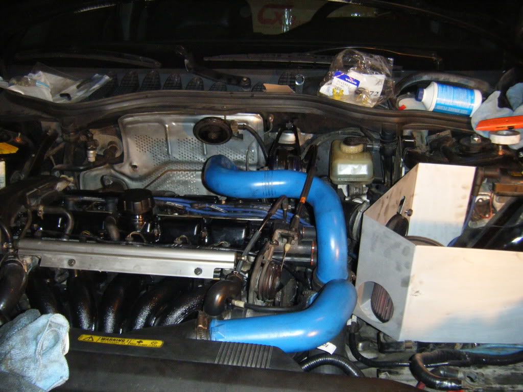

Engine basically put back together. The "awesome" blue intercooler piping is coming out since I have to wait a week for the heater core pass through to come, so I can install my FMIC in the time being.

Was that pivot point something you had to add over the factory setup?

The pivot pin was available in the 1996+ M56Hs. It was not included in the pre 96s because without the ball seat the shifting was smoother supposedly. But they added it in 96 to allow for more fork travel. So pre 96 it is not factory, 96+ it is factory.
Here is a video that shows the motion of the shifter fork before and after the ball seat is added:
http://www.youtube.com/watch?v=r2JyV...layer_embedded
Oh, and it's all pretty much back together, that part that is broken in the bottom is the heater core firewall pass through. Have a new one on the way, so hopefully I can wrap this up this coming weekend.

I will check the link out and maybe install it when I pull my tranny out adn see what happens.

Yeah, definitely check it out. Noticeable difference with and with out it.

Checked the Vid out and it I see a big difference. My throw out bearing is chattering already. I am so pissed but if I am taking it all apart I might as well put the R clutch in and install the clip.

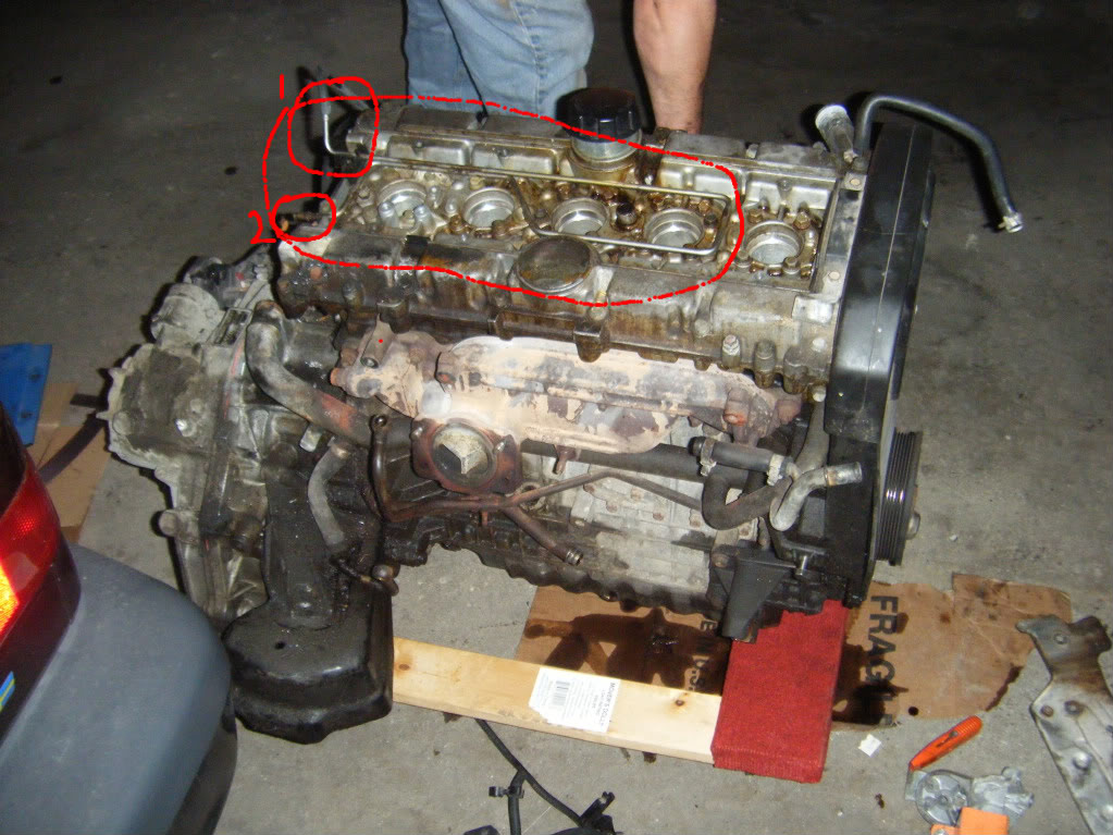

This one; it has two nipples on it and comes out the driver's side of the block.
Yeah, tell me about it, I had to pull my engine back out just to install the clip. After I saw that video, I realized it was completely necessary.

Yes you can remove the pipe it is basically a cooling loop. Just remove it and put a hose to replace it.
Yes just swap the ECU's and remove the part on the fan schroud.
I think I am going to put the upsolute tune back in and when I do the PCV I will put the Non-EGR intake on and polish it.

OK, is it part of the PCV system or something? I have all of my vac lines in, including the PTC since I have the newer manifold with the nipple on the manifold, so I think I'm going to just remove it and cap off the port on the vac tree.
It's definitely nice not having that huge metal tube going back to the exhaust manifold.

I think it is part of the PCV system But it is not needed. Just remove it.

Done. You know what, now that I think about it, I remember having one end of it hooked up to the vac tree, but I don't remember if I ever had the other end hooked up to anything. LOL. Major vac leak kinda.
