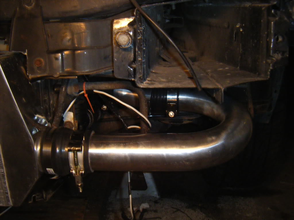

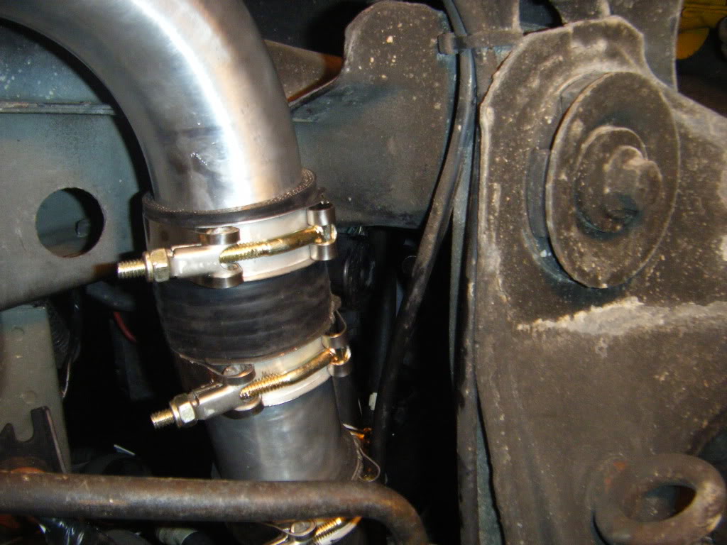

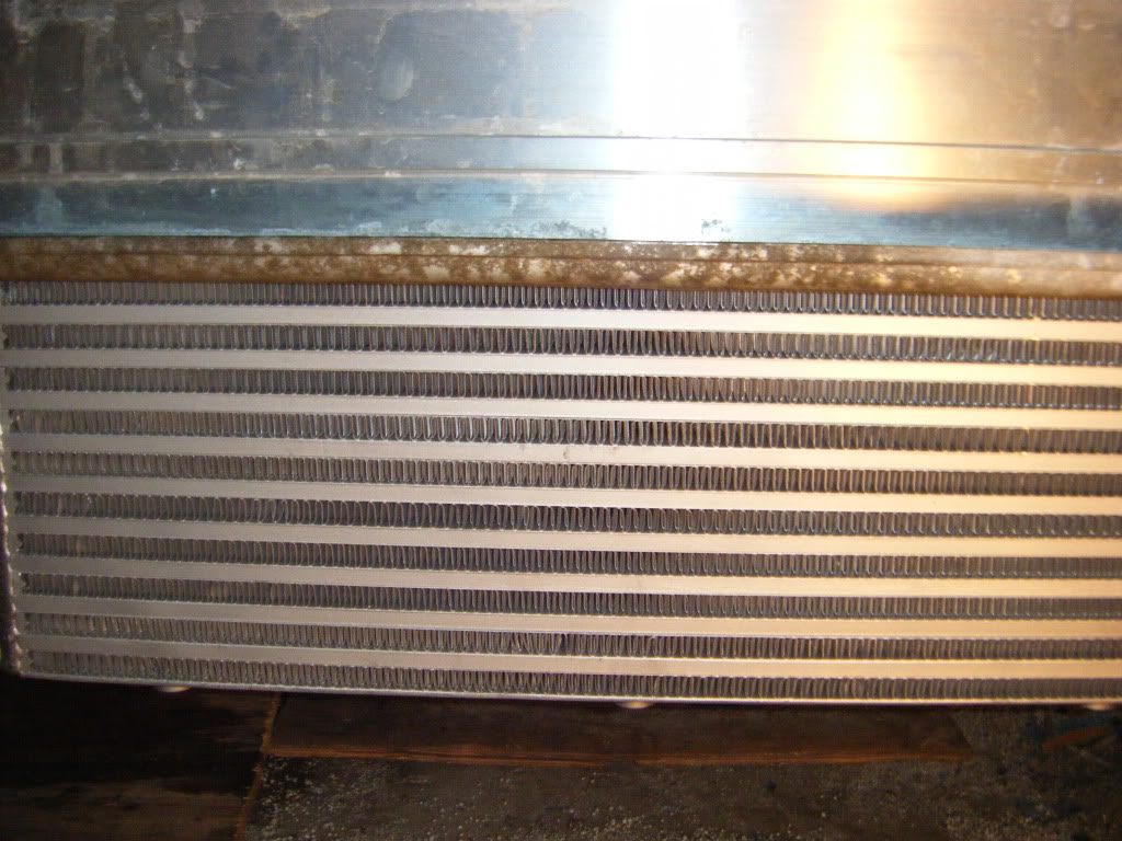

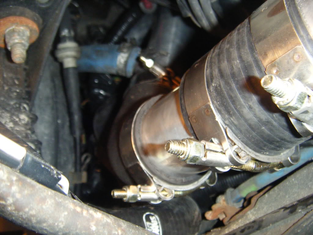

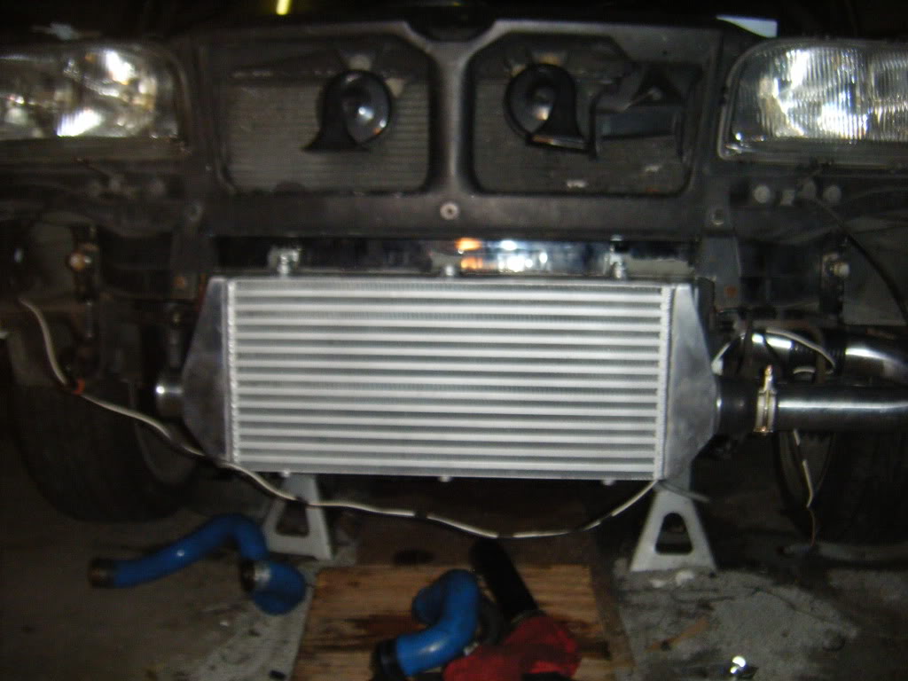

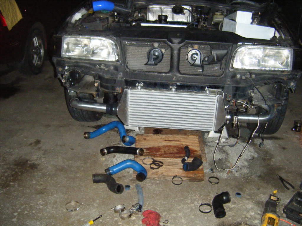

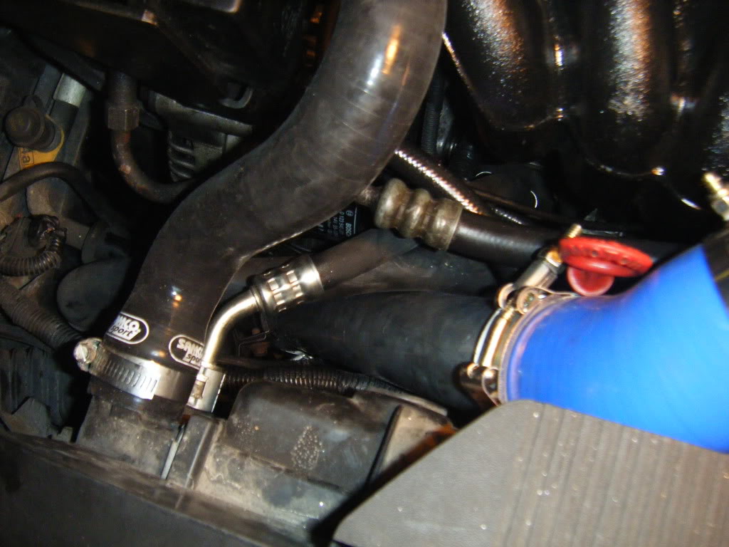

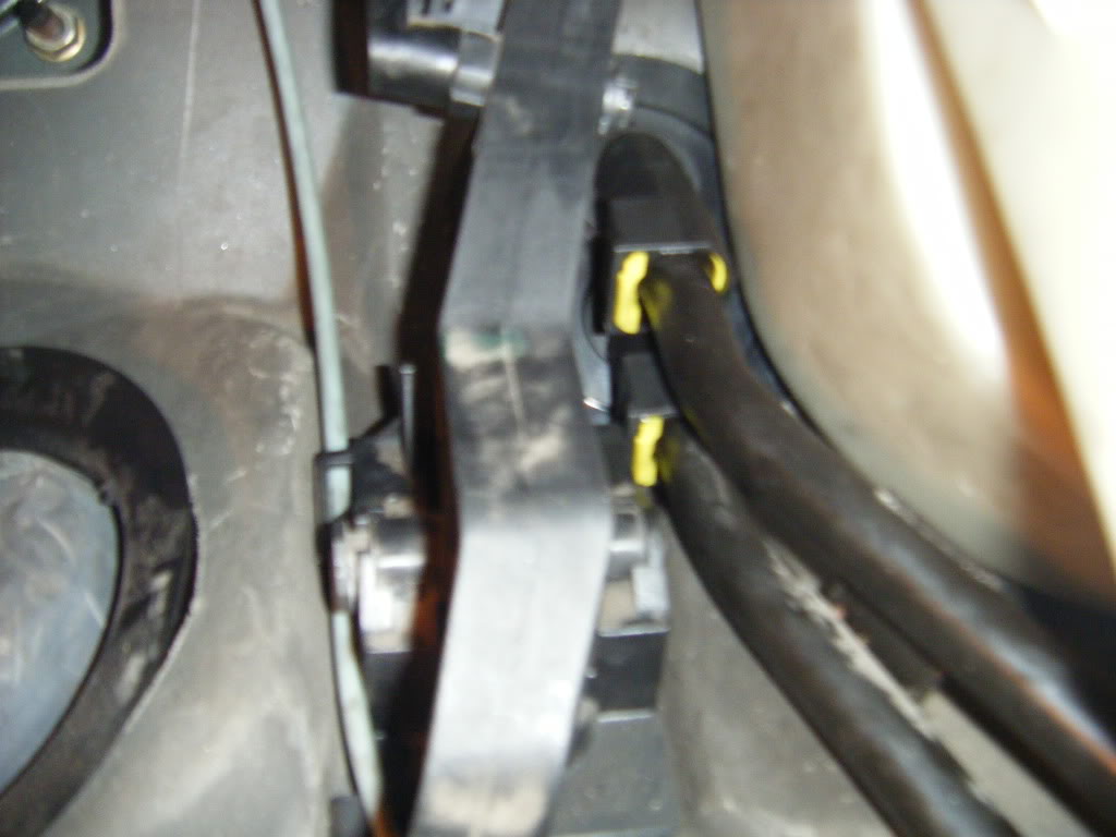

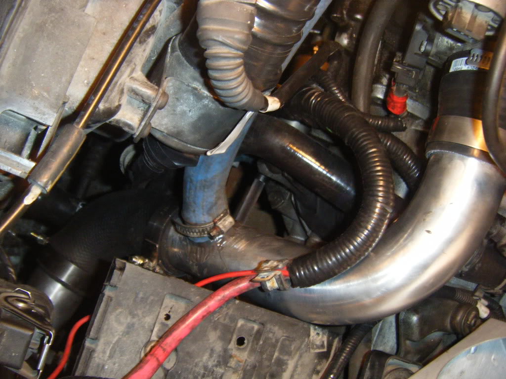

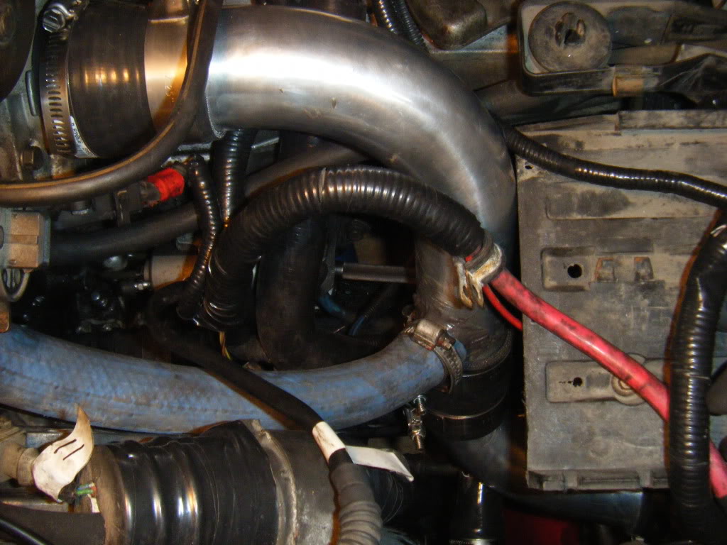

intercooler
I have to shorten the cold side a bit because the fog light doesn't fit with the current configurations.

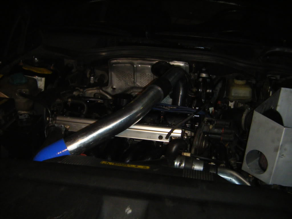

over the engine, bad pic, but you get the idea

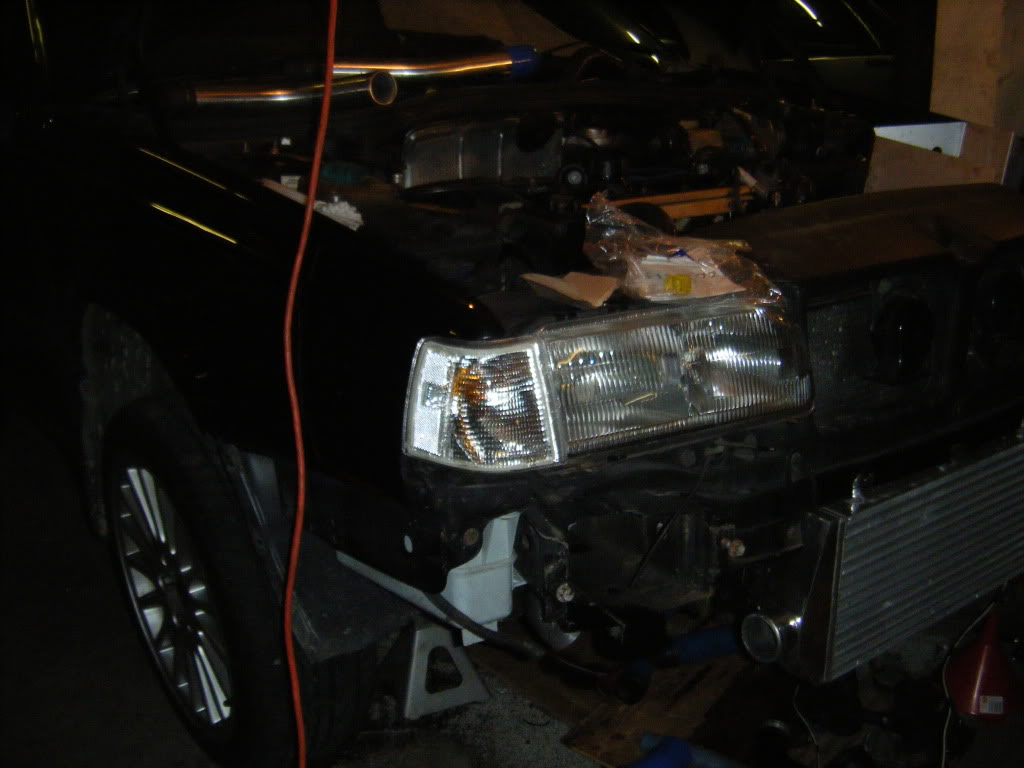

clear corners

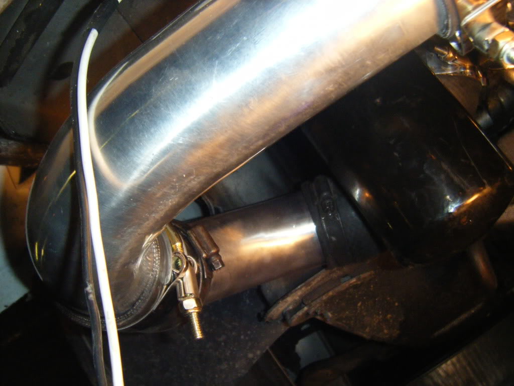

hot side
the pass through. PITA
how far the intercooler hangs below the bumper support. It's just about level with the radiator, so it shouldn't pop out below the bumper at all.

Looking good!!!
That intercooler looks BIG!
Old Jun 6, 2010 | 07:28 AM
  #498
gilber33's Avatar
Joined: Apr 2008
Posts: 3,948
From: Milwaukee, WI
Originally Posted by tech
Looking good!!!
It is, I had to cut away a good amount to make it fit, but once you have all of the piping on there, it really holds firm. This one is 9" tall.
Old Jun 6, 2010 | 07:37 AM
  #499
tech's Avatar
Joined: Sep 2004
Posts: 36,349
Likes: 46
I think I might go a little smaller. If it is that tight it might not fit on mine. The passenger side by the bumper support is bent on my car from the PO.
SO I think I will have to go a little smaller to make it all work.
Old Jun 6, 2010 | 07:49 AM
  #500
tech's Avatar
Joined: Sep 2004
Posts: 36,349
Likes: 46
BTW what did you mount the intercooler to?
