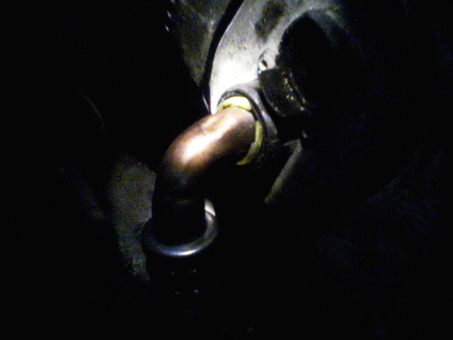

When I removed the old heater hoses, I was very careful to get out all the old o-rings and spacers (I double-counted to make sure they were really all out). As I prepped the new URO hose to go in, I set it up like so (see photo #1):
As I pressed it into the coupling unit, it never quite seemed to click. I tried to situate the clip properly and then press the hose in, but...no palpable "click." I tugged on the heater hose to see if it was firmly in place, but I was able to pull it out, with the entire connector kit remaining in the coupling. What?

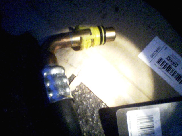

I pushed the hose back in. It looks like this now (see photo #2):
I don't really believe it would hold up to system pressure, but I don't know how to manipulate it to be sure it's "in place." On top of that, I don't really know how to get the plastic connector kit out of the coupling without breaking it.
