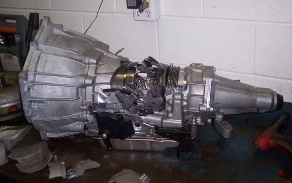

You can always call around and find a shop or AAMCO to do a free diag. Since your car is driveable it would allow someone with knowledge to hear and feel the problem first hand. ??
I'm keeping my fingers crossed for you.
Slimflex2, if you're going to copy my advise and good wishes at least give me credit (just kidding)
But as for 262740850, you made me go dig out my manual .
Cold transmission: oil temp 105F or 40C. This is a normal temp after idling for about 10 minutes. At temps below 105F or 40C the level may be below the MIN mark.
Warm transmission: oil temp 169F or 80C. This temperature is reached after driving for about 30 minutes. At oil temperatures above 190F or 90C the level may be above the MAX mark.
Remember you should never be able to see the inside of your transmission from the outside !!
