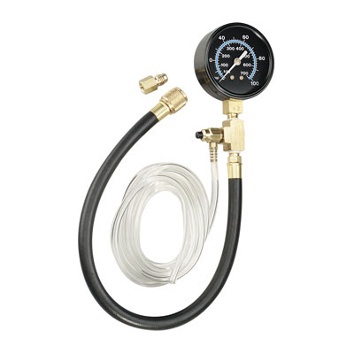

Old Jul 16, 2012 | 12:42 PM
Originally Posted by slimflex2
you dont have to start the engine to check for fuel pressure.here is a link to a video on how to do it.just get a gauge and do the test.try these three options given above and get back to us.Good luck Buddy
How To Check The Fuel Pressure On A Volvo - YouTube
Are you kidding me ?? Why not just get the right tester that just screws onto the end of the rail and doesn't make you unscrew that schrader valve core. It's so much simpler and eliminates the chance the hose comes loose and sets your car on fire.
