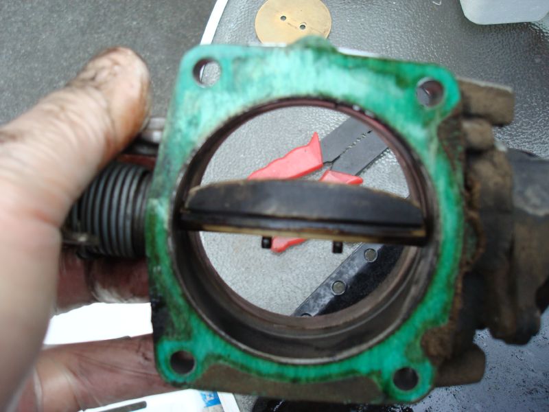

Turbo throttle body on the left, NA throttle body on the right.
NA intake manifold, NA throttle body, and a S90/960 throttle plate.

  #17
This is the plastic block on the throttle plate.
