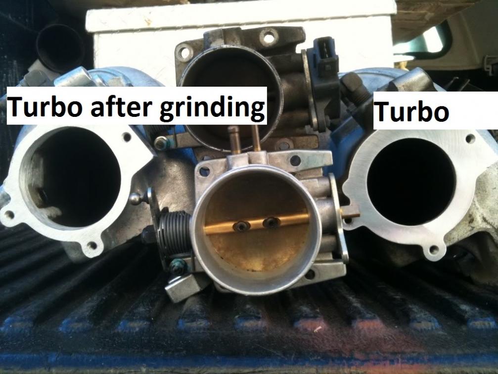

I have the N/A throttle body to go onto my car this tuesday. I've made all the intercooler piping up ready to bolt on.
I have to bore out my turbo manifold though. All the N/A 20 Valve engines here in Aus have the VVIS valve thingy inside them.

Here's what you need to do:

Is there some particular reason for grinding the turbo intake? There's time, effort, and hoping you don't screw it up, when it seems to me the easiest solution is to just grab the manifold from the car you're pulling the throttle body off of

Originally Posted by Brick850
So I can just block this off then? I don't have these on mine.
Yes, you can run a hose from one to the other, pinch and solder them, take them out and tap a ball bearing in, take them out and JB weld. Lots of options.
Thats the reason. You already have the manifold. The other reason is that not all N/A manifolds will work. Some have that flap system in them, you dont want that.
I'm grinding mine because all the N/A manifolds in australia had the VVIS flap system in them.
Only the 10 valve engine manifolds didnt.
I'm grinding mine because all the N/A manifolds in australia had the EGR flap system in them.
Are you talking about V-VIS system or the EGR valve?
Plugging the EGR valve on the intake manifold is easy as pie; drill and tap for a pipe-thread plug and drive one in there. Yeah if you're talking V-VIS, that's too much bother.. but only the '93s and some of the '94 N/As have that in the states..

Yeah VVIS is the thing I was referring to. I'll chalk it down to the fact I have man flu at the moment.
Or you pulled the throttle body off a 960 because you wanted one with a smooth plate (no plastic blob) and it has one extra intake runner
