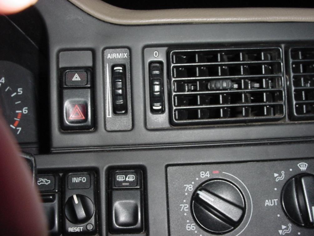

The first year I had mine I thought the heater really sucked, sucked bad and especially for a vehicle designed in a northern European country that has weather similar to here (Minnesota).
Silly me. Owners should always read their owners manual to see what does what. Can't say this is your problem but mine was the dial on the dash next to the emergency flasher switch that is marked "AIRMIX" was open. If it's open at all it dilutes the heated air and makes the heater feel very wimpy. Still blows with enough force but the discharge temp is affected.
If you haven't noticed it before, now would be a good time to make sure it's closed. My feet were much happier once I closed it and my defrost actually could !!

kiss- yeah that airmix thing had me going for a little while too. Why can't the heat / ventilation system on these things be simpler. It's like they have built in 5 levels of redundancy! How many combinations do we need? Suffice it to say the airmix **** is closed. An now that I fixed that little dog bone link thing, the recirc control works too. According to the manual, I've got it set for winter (orange-yellow light off). You might have colder winters than me, not sure. I'm in Syracuse, NY. Bet we get more snow!

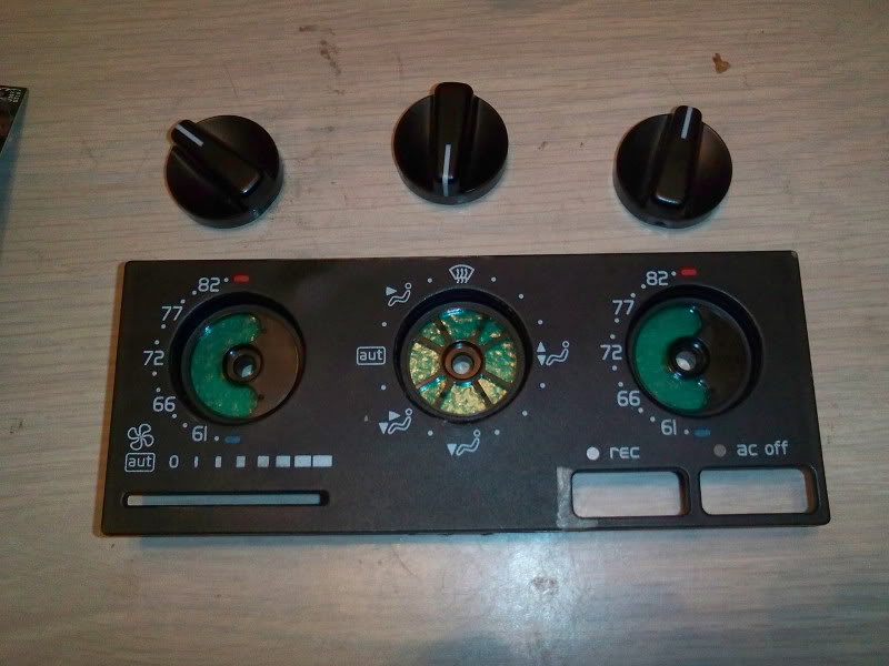

Old Dec 1, 2012 | 02:29 PM
Originally Posted by daver80
OMG- Fan seems to blow fine, all 4 speeds at any engine speed.
I'm going to "assume" it's manual (MCC) as he's saying all four speeds compared to the infinite speeds on the electronic (ECC) unit.
Attached Thumbnails Weak Cabin Heating-heat-ac-ecc-panel.jpg   Weak Cabin Heating-heat-ac-mcc-panel.jpg

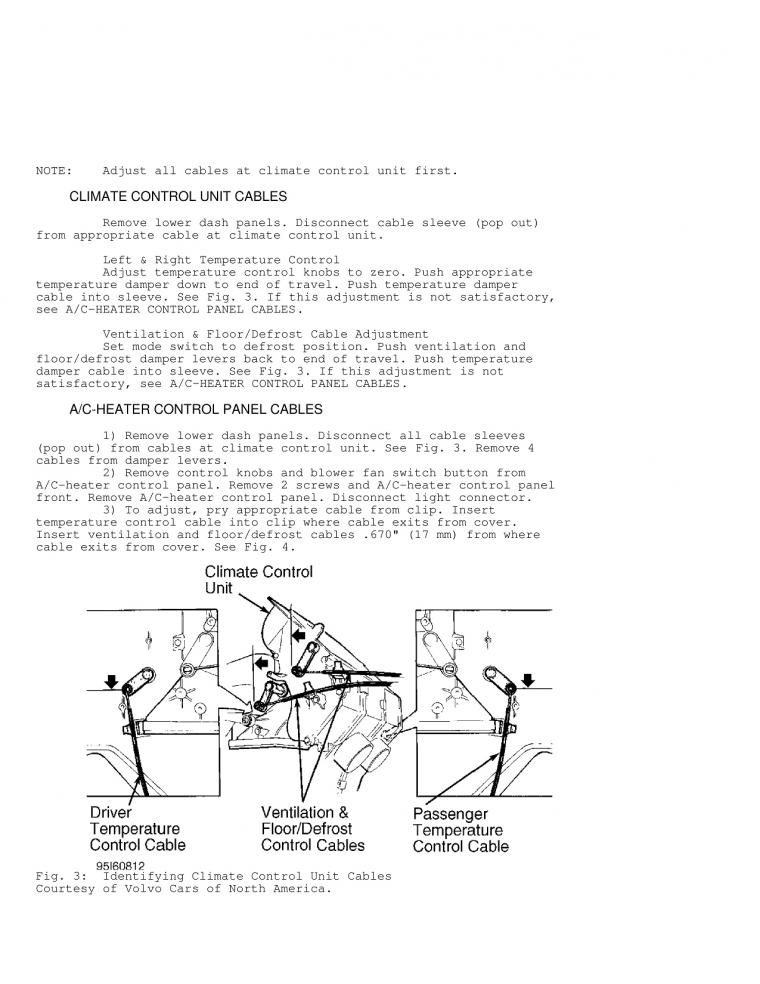

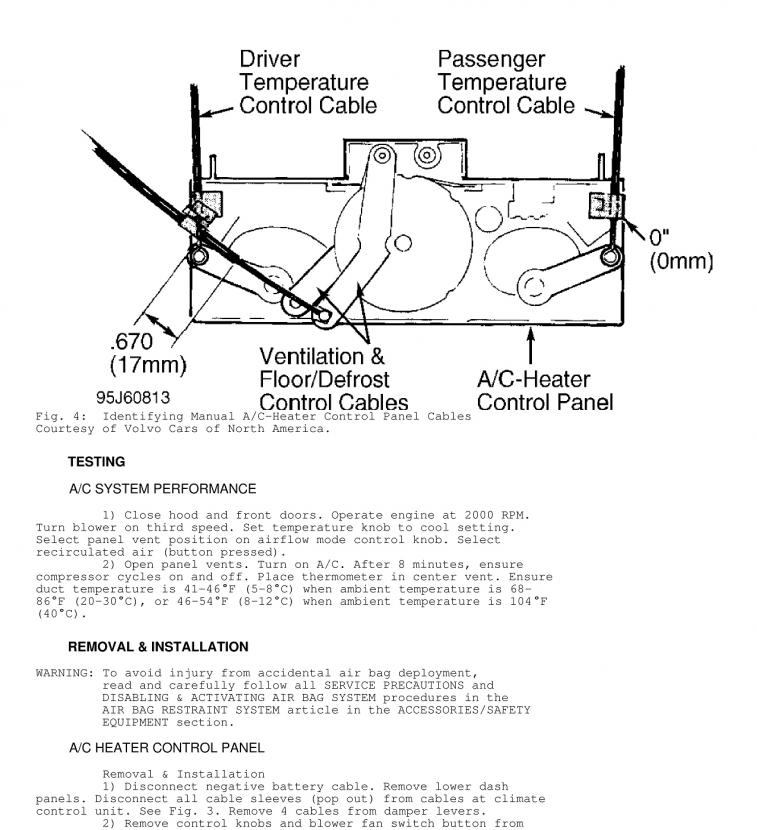

Duh, I wish I knew this PDF Xchange Viewer long time ago so I didn't have to print every page from PDF file and scan it.
If the air trim box is ok, the last place is the temp control panel.
I hope they are of some use.
