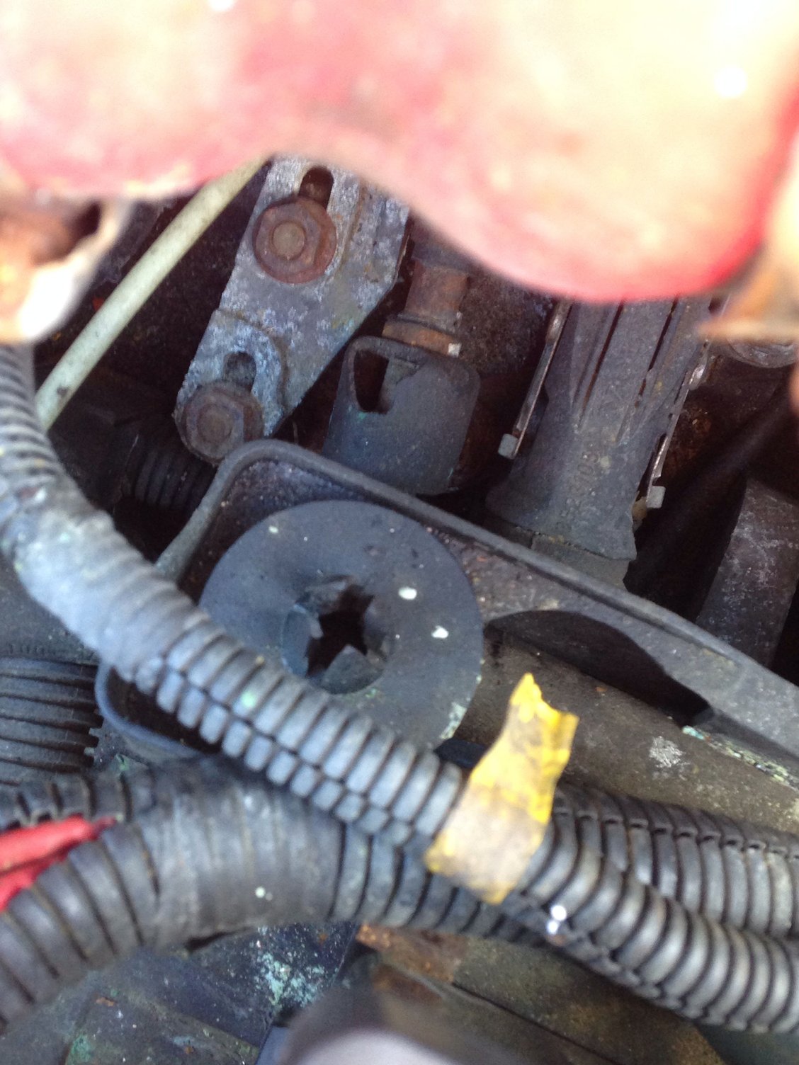

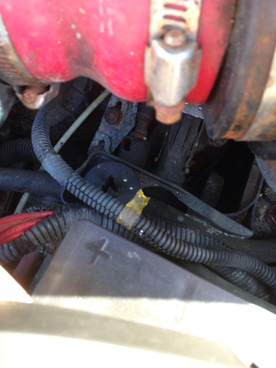

Can anyone tell me what this hole is in? Can't identify what this is. My 94' 850 has been starting intermittently. It will start and an hour later it won't. I put in a brand new battery and nothing changed. Lights and radio will come on but there is no engine turnover and no sound at all really. Wondering if this line could be the cause of that??? Thought it may be the starter or PNP switch but hoping maybe this is it? Could I tape it temporarily? Thanks!!!

its kind of hard to tell exactly which wire you are referring to and where on the engine. with that said, I doubt if the lack of a tie down is causing the intermittant start. Try doing a shifter row (P to Lo to P 20x fast) to see if you can clean up the PNP contacts next time it fails to start. Also check the battery terminals to make sure don't have any corrosion or loose connectors up there.

Can you see the big hole in the photo? It occurs on a line that's right behind the battery. Between battery and air filter. I tried the moving shifter about 10-15 times but not super fast. I will try that again next time. I just put the new battery on and tightened it down pretty well. Thanks!

The adjustability of that makes me think it's the shifter cable. That keeps dirt out of the cable, I think. There is a bellows hooked to that, I think.
