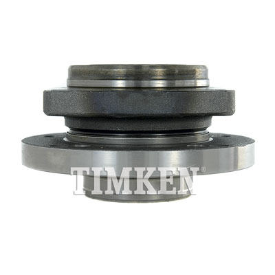

where would i go or what would i look for to buy one of these bearings?
Old Jun 29, 2012 | 02:21 PM
  #42
You can order one on line at FCP or Rockauto or walk into a NAPA, Oreilly, Autozone or ........ and ask for a hub assembly. Check out the difference in price and warranty and choose what you're comfortable with.
Attached Thumbnails Wheel Bearing - Front (Write-Up)-hub-assy-front.jpg   Wheel Bearing - Front (Write-Up)-hub-assy-rear.jpg   Wheel Bearing - Front (Write-Up)-hub-assy-side.jpg

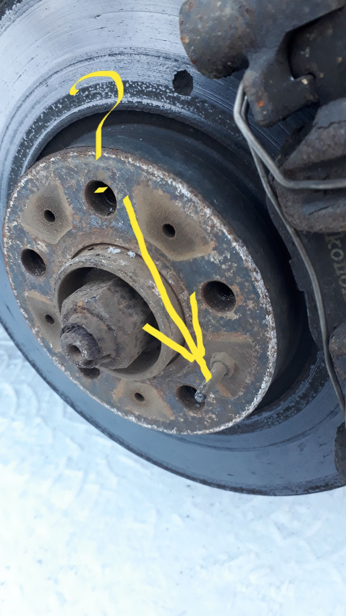

Hi. I just got my first Volvo and this is my first post to the forum.
The OP mentioned and showed a photo of the "mini stud" being removed. Can anyone tell me the function of that part please? I have a set of wheels which would fit, if only that stud wasn't there!
Thanks a lot, take care
- Tony-

its just an alignment pin to help set up the rotor and wheel during assembly. It just screws out (10mm). I've always removed when doing new rotors.
Sorry to be dense, I just don't want to screw anything up... are you saying I can safely discard them then?

no, don't discard, just take off then reinsert during reassembly

Ah. That's my problem, that stud prevents me from using the wheels I have, which would otherwise fit perfectly
It's just an aid. You can remove it and mount your wheels if everything else lines up (make sure they're the right size, including the lug hole depth. You need a certain about of thread engaged for these heavy cars).
