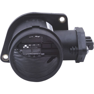

I have enough mechanical ability to have replaced the alternator and spark plugs but please don't give me too much credit. I don't know anything about maff sensors (Mass Air Flow or MAF. It's the sensor that's attached to the air filter housing and measures how much air the engine is getting), schrader valves (Schrader valve, it's the valve at the end of the fuel rail that you need to remove the big black cover to see. It's real close to the distributor) or what the question "Is there any cel?" means (Check Engine Light or CEL also called a MIL for Malfunction Indicator Light).

first picture is the mass air flow sensor that should be bolted to your air cleaner with a black plastic/rubber hose running to the turbo or throttle body.
