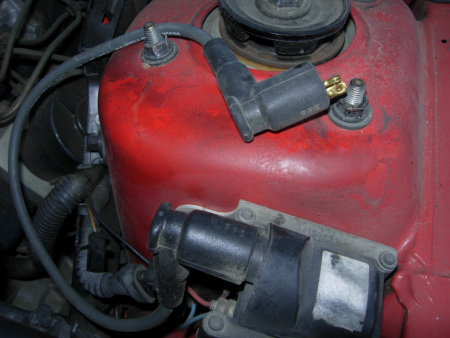

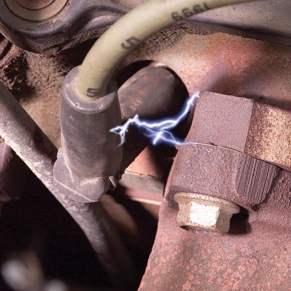

[QUOTE=wyd-open;339958] I checked for fuel pressure and I can hear the pump run when I first turn on the key so I know it's not a fuel problem. /QUOTE]
Did you actually check the fuel pressure to make sure you have some or did you only listen for the pump ?? Hearing the pump run doesn't guarantee you have any pressure or volume up at the rail.
But no spark is no spark.
A flashing CEL usually means that a serious misfire of one or more cylinders is currently in progress. Did you check for spark at the end of one of the spark plug wires and or from the coil lead ??
The coolant temp sensor should adjust the timing and fuel delivery according to the map in the computer. If the sensor fails you should still have fuel and spark but you would likely be running richer as the computer is designed to go rich if the ECT sensor fails.
