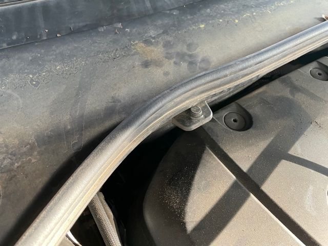

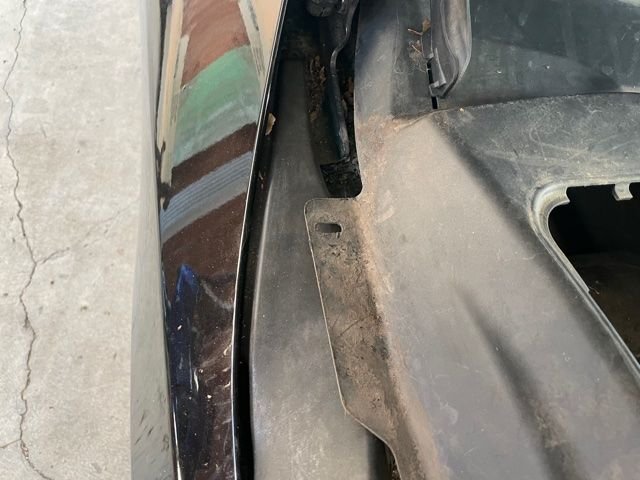

Old Apr 22, 2021 | 06:19 PM
rcs95d's Avatar
Joined: Apr 2021
Default Start battery changed - with pictures
Ok friends...I just decided to go for it. bought the battery from my volvo dealer, about 115 bucks. Then I found the diagrams on volvo's website showing the relative location on my left side drive 2015 v60 t5. Took off the mesh panels around the r design bar, Took screws out and removed the r design bar. Then popped out the cowling plastic holding pins that hold the cowling on below the wipers. Popped off the right side windshield trim from the cowling. Then just pulled up the cowling piece to expose the battery. Piece of cake! Then I used metric sockets to remove the battery terminals (I can't remember the mm). Then used another metric socket to remove the battery holder. Took out the battery, swapped the new one in, but it all back together and voila. I drove it around the block, start stop worked perfectly and I didn't have to do any special work on the computer.
I learned that the battery controls more than just the stop/start function. It is essential in an idle engine state too in controlling extra cooling fans and other things that keep the vehicle running correctly. Is worth the money to fix if you can do this yourself. See some pics attached.
